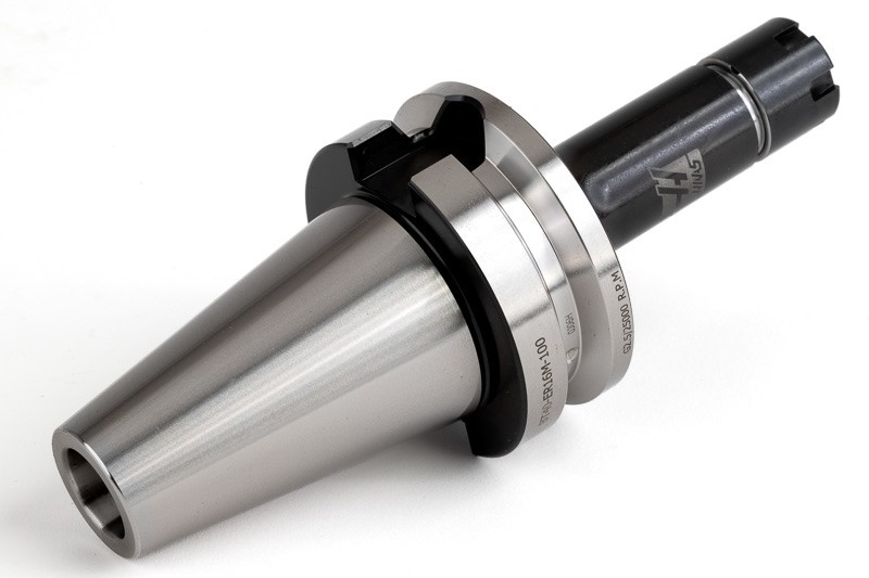

BT40 ER16M Collet Chuck x 100mm Gage Length, TSC
Part #: 04-0918
BT40-ER16M-100
Customer Rating:
Price: 79.95 ( / unit)
Price: 1998.95 ( / unit)
Price: 594.95 ( / unit)
Price: 359.95 ( / unit)
Price: 839.95 ( / unit)
43.97

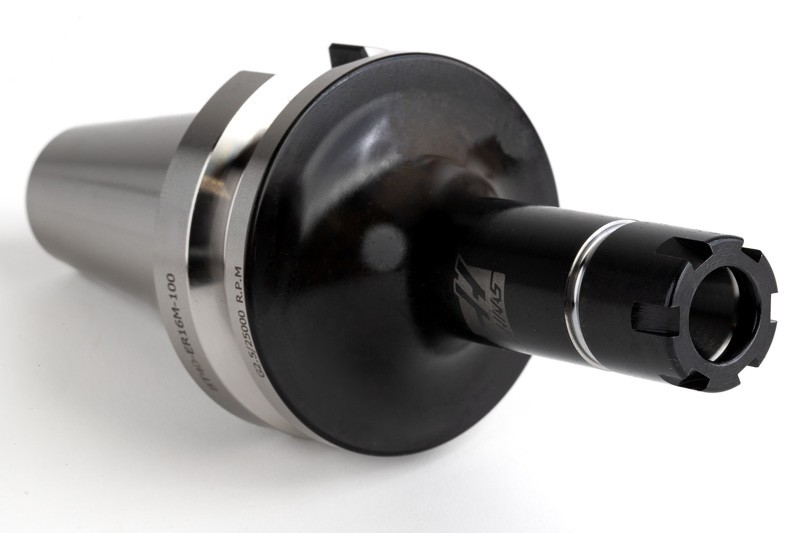

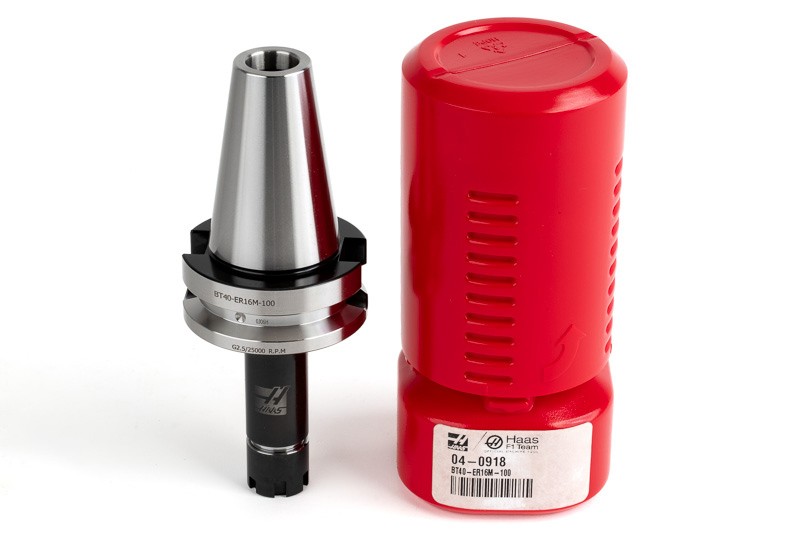

This BT40 ER16 collet chuck accepts a variety of ER16 collet styles, and has a 100mm gage length. The double-taper collet design provides high clamping force for round, smooth shank tools, and offers a wide gripping range with excellent TIR and balance. It is through-tool coolant (TSC) capable, with a M16x2.0 pull stud/retention knob thread.

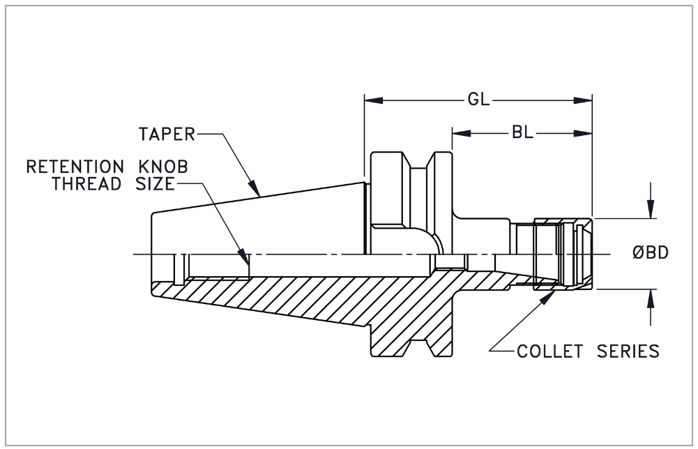

Taper BT40
Collet Series ER-16
[ØBD] Body Diameter 22.0 mm
[GL] Gage Length 100.0 mm
[BL] Body Length 73.0 mm
Concentricity 0.005 mm
Balanced to RPM 25,000
Retention Knob Thread Size M16X2.0
Through Tool Coolant Yes
Spindle Drive Slots Yes
Weight 2.4 lbs \ 1.1 kg
