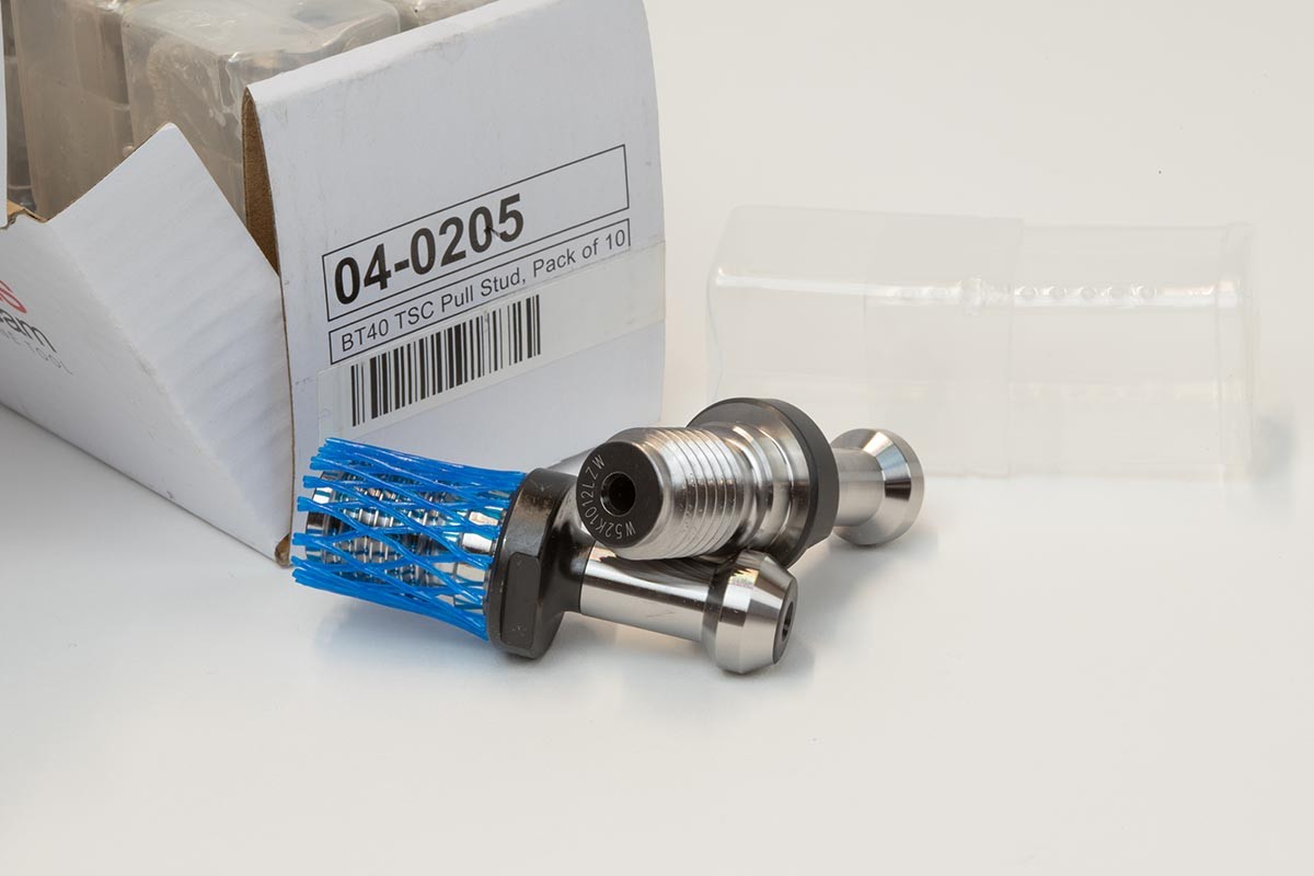

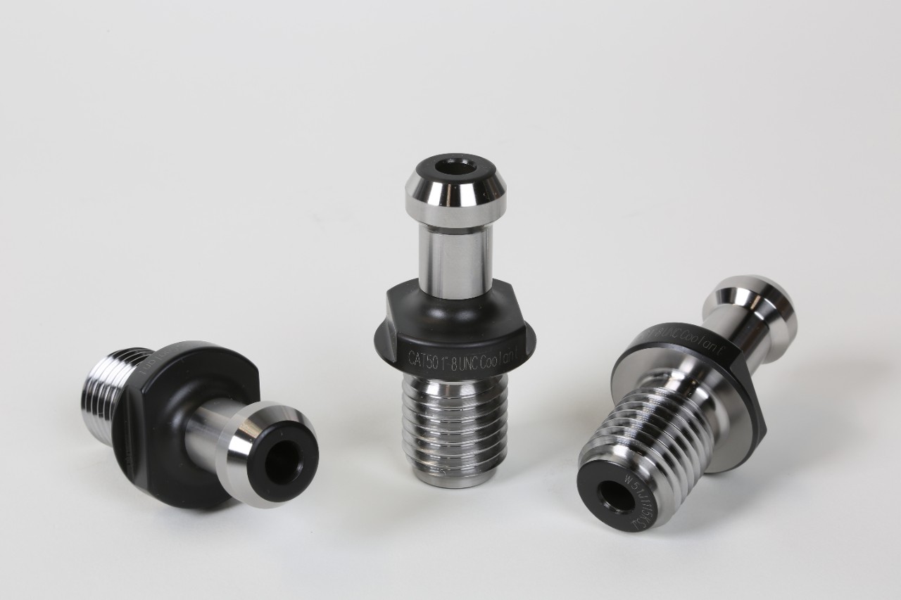

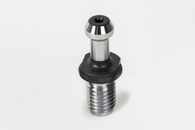

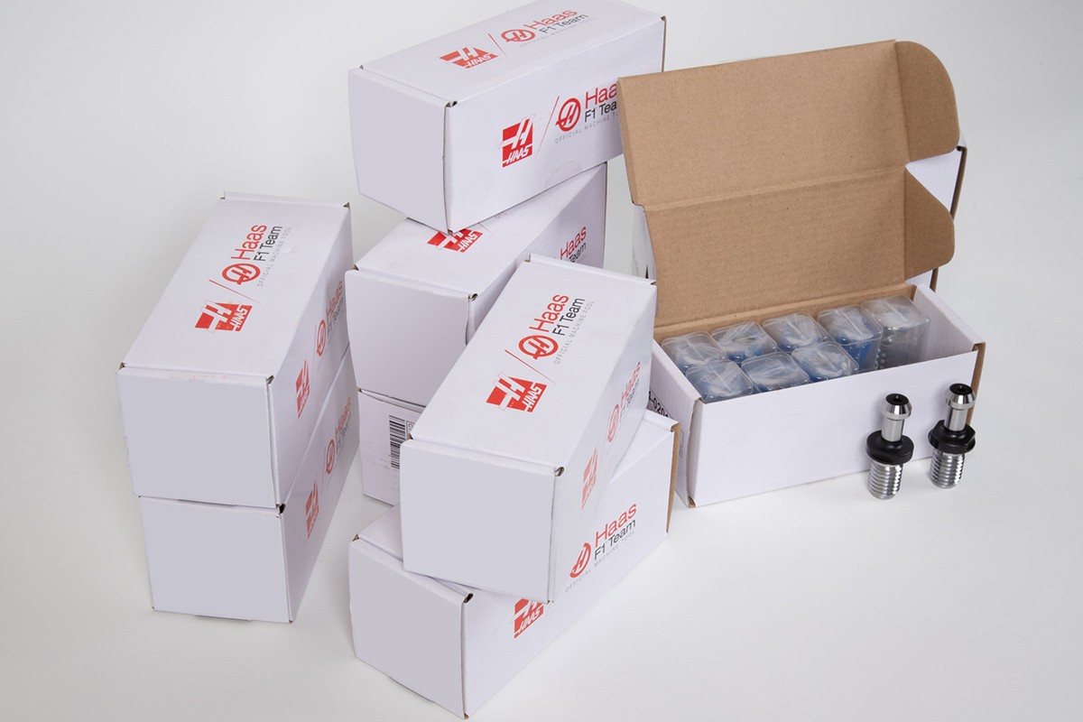

Haas BT40 Pull Stud/Retention Knob, TSC - Pack of 10
Part #: 04-0205
BT40 TSC PULL STUD, PACK OF 10
Price: $125.95 ( / unit)
Price: 2173.95 ( / unit)
Price: 646.95 ( / unit)
Price: 86.95 ( / unit)
Price: 391.95 ( / unit)
Price: 912.95 ( / unit)
$75.97
1524.97
453.97
60.97
274.97
640.97
These BT40 TSC pull studs/retention knobs are designed specifically for use in Haas BT40 machines. They feature a 45° knob angle, 15mm knob diameter, and 10mm neck diameter, with a M16x2.0 thread size. These pull studs have a through-hole for through-tool coolant (TSC). Pack of 10.
Taper BT40
[ØK] Knob Diameter 15.0 mm
[ØN] Neck Diameter 10.0 mm
[W] Wrench Flat Diameter 18.8 mm
[OAL] Overall Length 59.94 mm
[FT]Flange to Beginning of Tap 28.0 mm
[FE] Flange to End of Knob 34.8 mm
[KA] Knob Angle 45 Degree
[TP] Thread Pitch M16x2.0
Number of Pieces 10
Through Tool Coolant Yes
Weight 1.6 lbs \ 0.7 kg

Hi Haas Team. Is this the right pull stud for the GM-2 with BT40 tool changer?
1 Answers
Haas Tooling
Jan 25 2023
Hello. Yes, these pull studs are designed specifically for Haas machines with BT40 spindle tapers like the GM-2 equipped with a BT40 spindle and tool changer.
