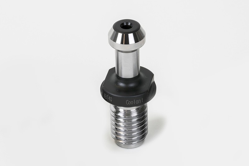

These BT40 TSC pull studs/retention knobs are designed specifically for use in Haas BT40 machines. They feature a 45° knob angle, 15mm knob diameter, and 10mm neck diameter, with a M16x2.0 thread size. These pull studs have a through-hole for through-tool coolant (TSC). Sold individually.
Taper BT40
[ØK] Knob Diameter 15.0 mm
[ØN] Neck Diameter 10.0 mm
[W] Wrench Flat Diameter 18.8 mm
[OAL] Overall Length 59.94 mm
[FT]Flange to Beginning of Tap 28.0 mm
[FE] Flange to End of Knob 34.8 mm
[KA] Knob Angle 45 Degree
[TP] Thread Pitch M16x2.0
Number of Pieces 1
Through Tool Coolant Yes
Weight 0.2 lbs \ 0.1 kg
