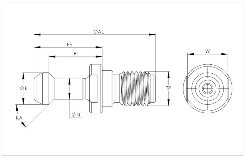

These SK40 \ DIN 69871 pull studs/retention knobs are designed specifically for use in Haas CT40 \ SK40 (ISO40) machines. They feature a 45° knob angle, 15mm knob diameter, and 10mm neck diameter, with a M16x2.0 thread size. These pull studs DO NOT have a through-hole for through-tool coolant (TSC). Sold individually.
  • Technical Documents
Taper SK40 \ DIN 69871
[ØK] Knob Diameter 15.0 mm
[ØN] Neck Diameter 10.0 mm
[W] Wrench Flat Diameter 19.0 mm
[OAL] Overall Length 57.15 mm
[FT]Flange to Beginning of Tap 25.1 mm
[FE] Flange to End of Knob 32.1 mm
[KA] Knob Angle 45 Degree
[TP] Thread Pitch M16x2.0
Number of Pieces 1
Through Tool Coolant No
