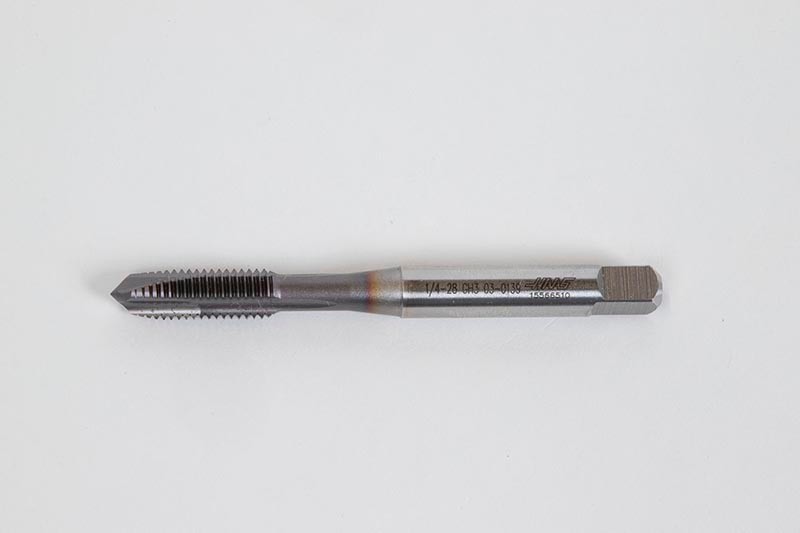

1/4"-28 UNF HSS-E Spiral Point Tap, 0.255" Shank x 0.591" Thread Length, 3XD, Plug, 3 Flute, GH3, TiCN Coated
Part #: 03-0139
1/4-28 SP PT MULTIPLE MATERIAL TAP
Customer Rating:
Price: $16.95 ( / unit)
$9.97
ISO MATERIAL CHART
Thread Series UNF - Unified Natl. Fine
Thread Size 1/4"-28
Primary Workpiece Material P - Steel, N - Aluminum, M - Stainless Steel, K - Cast Iron
Tap Type Spiral Point
Chamfer Type Plug
Shank Type Square
Material HSS-E
Coating TiCN
[TPI] Threads per Inch 28 tpi
Tap Drill Diameter 0.217 in
[ØDC] Cutting Diameter 0.25 in
[ØDMM] Shank Diameter 0.255 in
[L2] Chamfer Length 4P - 5P
[L1] Thread Length 0.591 in
[LU] Usable Length 1.0 in
[OAL] Overall Length 2.5 in
[SS] Square Size 0.191 in
[NOF] Number of Flutes 3
[FHA°] Helix Angle 0
Length / Diameter 3 X D
Thread Class GH3
Through Spindle Coolant No
