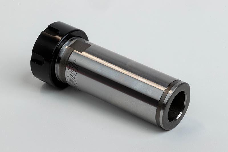

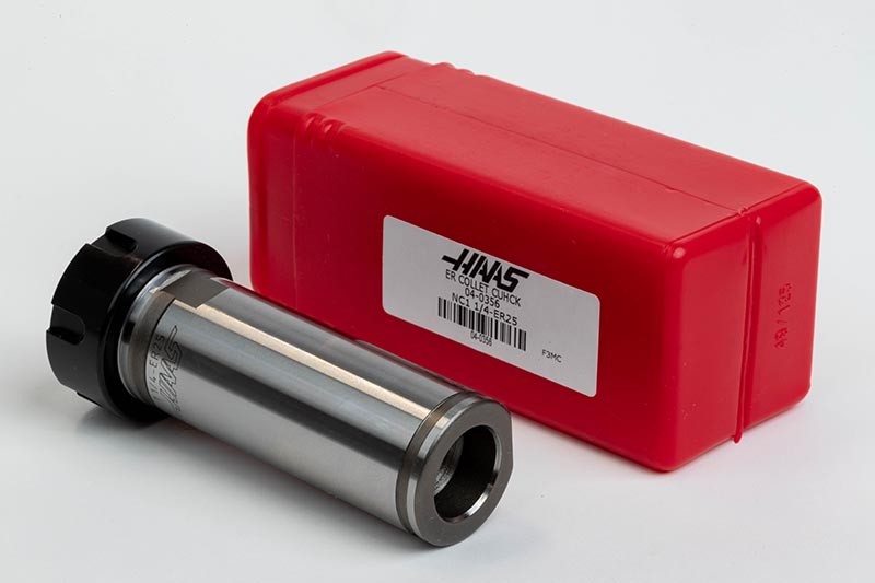

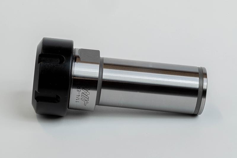

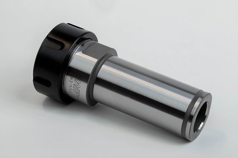

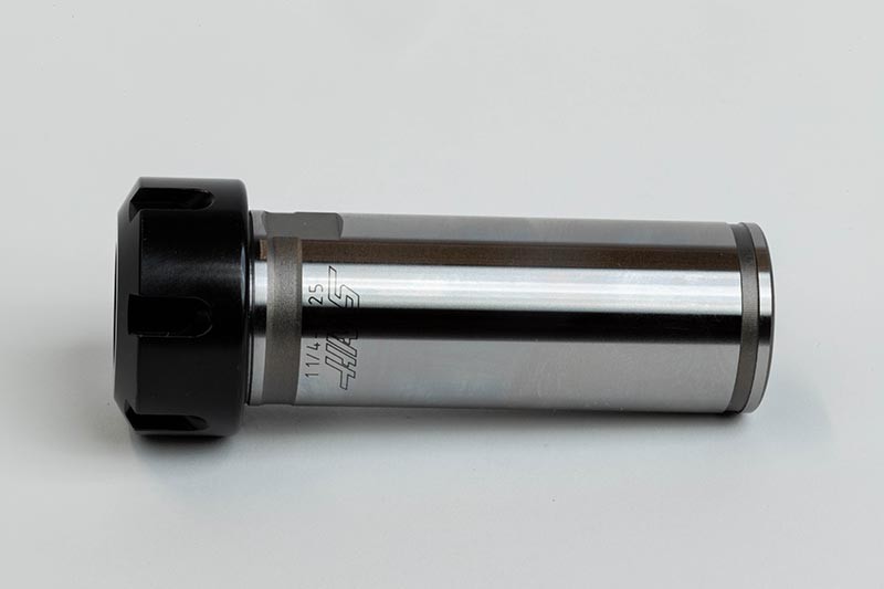

ER25 1-1/4" Straight Shank Collet Chuck, TSC
Part #: 04-0356
ST SHANK COLLET CHUCK 1-1/4" X ER25
Price: 88.95 ( / unit)
57.97
This straight shank ER25 collet chuck accepts a variety of ER25 collet styles, and has a 1.25 in \ 1-1/4" shank. The precision cylindrical shank has one flat, and will mount into any internal (ID) turning holder with the appropriate bore size and set-screw clamping. The double-taper collet design provides high clamping force for round, smooth shank tools, and offers a wide gripping range with excellent TIR and balance. The collet chuck is through-tool coolant (TSC) capable, and also may be used as an extended-length milling collet, by clamping it into the appropriate end mill holder.
Collet Series ER-25
[ØBD] Body Diameter 1.65 in
[ØDMM] Shank Diameter 1.25 in \ 1-1/4"
[LS] Shank Length 2.76 in
[LSCX] Maximum Clamping Length 3.94 in
[OAL] Overall Length 4.33 in
[FS] Flat Size 1.181 in
[TP1] Thread M16x2.0
Through Tool Coolant Yes
Weight 1.5 lbs \ 0.7 kg
