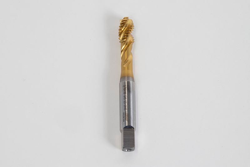

  4. 5/16"-18 UNC HSS-E Spiral Flute Tap, 0.318" Shank x 0.472" Thread Length, 2.5XD, Modified Bottoming, 3 Flute, GH5, TiN Coated

5/16"-18 UNC HSS-E Spiral Flute Tap, 0.318" Shank x 0.472" Thread Length, 2.5XD, Mod. Bottoming, 3 Flute, GH5, TiN Coated
Part #: 03-0145
5/16-18 SP FL TSC MULTIPLE MATERIAL TAP
Price: 22.95 ( / unit)
14.97
ISO MATERIAL CHART
Thread Size 5/16"-18
Primary Workpiece Material P - Steel, K - Cast Iron, N - Aluminum, M - Stainless Steel
Tap Type Spiral Flute
Shank Type Square
Material HSS-E
Coating TiN
[TPI] Threads per Inch 18 tpi
Tap Drill Diameter 0.26 in
[ØDC] Cutting Diameter 0.3125 in
[ØDMM] Shank Diameter 0.318 in
[L2] Chamfer Length 2P - 3P
[L1] Thread Length 0.472 in
[LU] Usable Length 1.126 in
[OAL] Overall Length 2.721 in
[SS] Square Size 0.238 in
[NOF] Number of Flutes 3
[FHA°] Helix Angle 40
Length / Diameter 2.5 X D
Thread Class GH5
Through Spindle Coolant Yes
