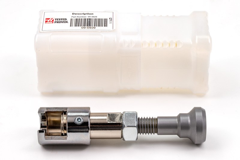

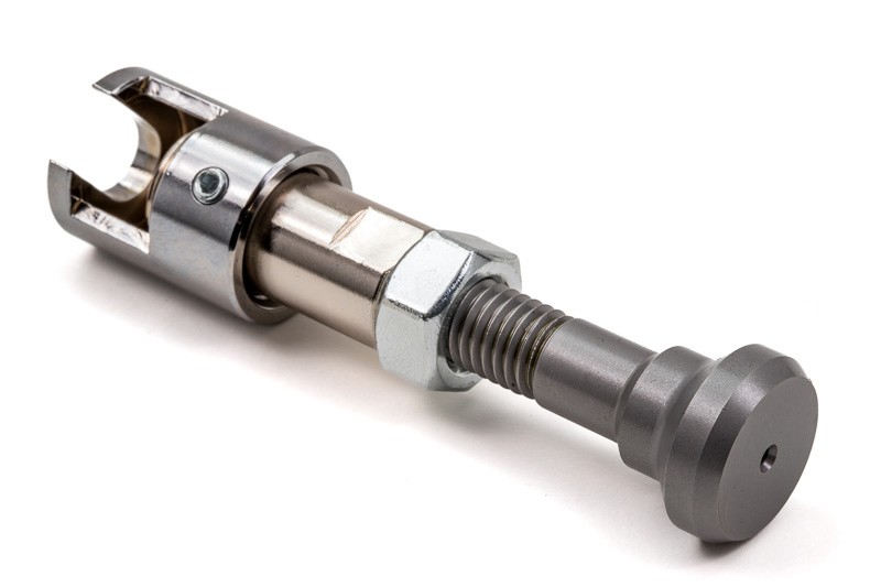

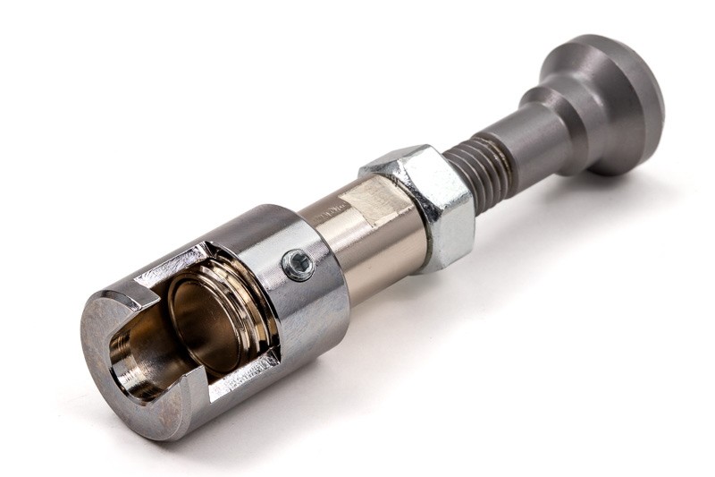

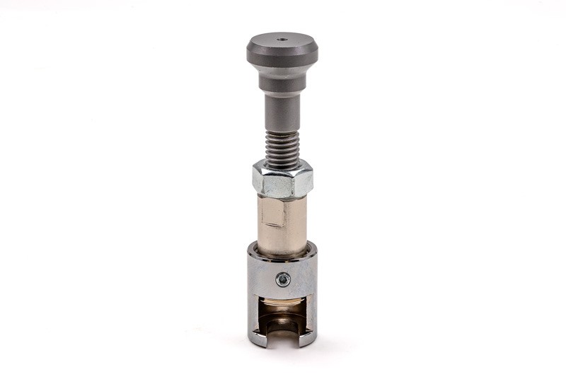

Replacement Pull Rod for HPTS/HTS600 Pneumatic Presetter Systems
Take full advantage of the precision-ground spindle taper sleeve by utilizing the pull rod attachment, along with the pneumatic system, to create a wringing effect between the taper sleeve and the taper of the tool holder. When the tool holder is clamped down correctly, the wringing effect reduces errors related to parallax, misalignment, or positioning of surfaces, ensuring that the measurement taken is as close to the true value as possible.
This is a replacement pull rod. The HTS600 is equipped with 40-Taper pull rods from the factory. However, a replacement pull rod may be necessary if the attachment is damaged or misplaced. This attachment may be used on the HPTS600 version if the unit has been equipped with a 40-taper presetter toolholder sleeve.

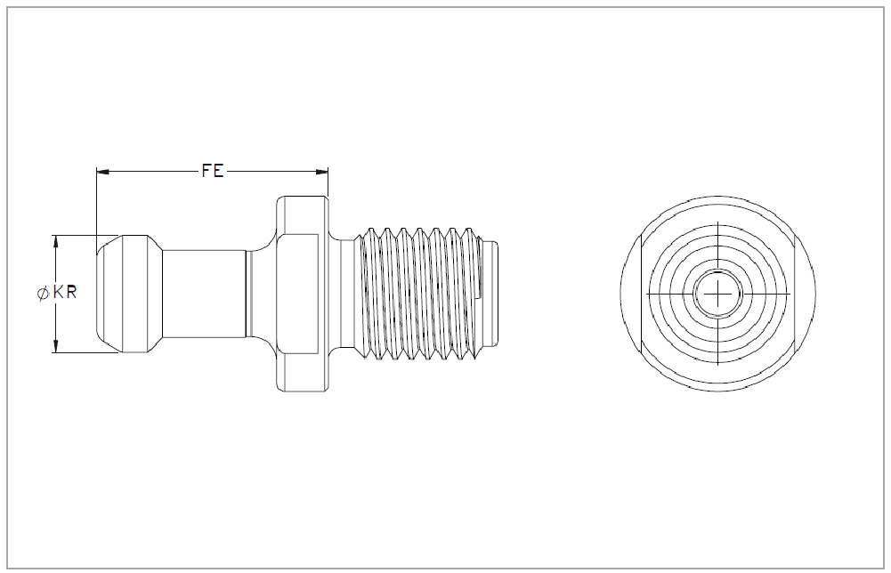

NOTE: This specific pull rod is for Haas, 40-Taper pull studs in which the FE dimension is found to be ≥ 1.25 in \ ≥ 32.0 mm and the ØKR dimension is between 0.43 in – 0.65 in \ 11.0 mm – 16.5 mm. The ØKR dimension is critical to ensuring the tool is properly clamped and secured during measurement. Using the wrong pull stud may result in the tool holder being pulled out without the pull rod. See parametric drawing below for details.
Type Pull Rod
Taper BT40, CT40, SK40 \ DIN 69871
[ØKR] Knob Diameter Range 0.43-0.65 in \11.0-16.5 mm
[FE] Flange to End of Knob ≥ 1.25 in \ ≥ 32.0 mm
