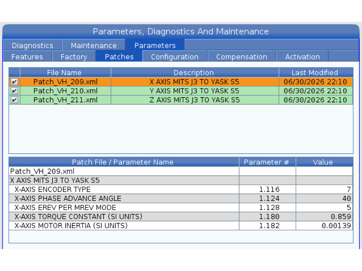

Reset the axis grid offset. Refer to the Axis Grid Offset - Mill 13.14 or Higher and Lathe 6.11 or Higher for CHC and Next Generation Control - Axis Grid Offset for the NGC.
Reset the axis tool change offset. Refer to VMC - Side-Mount Tool Changer - Set Parameter 64 - Z-Axis Tool Change Offset, Umbrella Tool Changer - Set Parameter 64 - Z-Axis Tool Change Offset for the CHC and the Next Generation Control - Side-Mount Tool Changer - Z-Axis Tool Change Offset, Next Generation Control - Umbrella Tool Changer - Z-Axis Tool Change Offset for the NGC.
