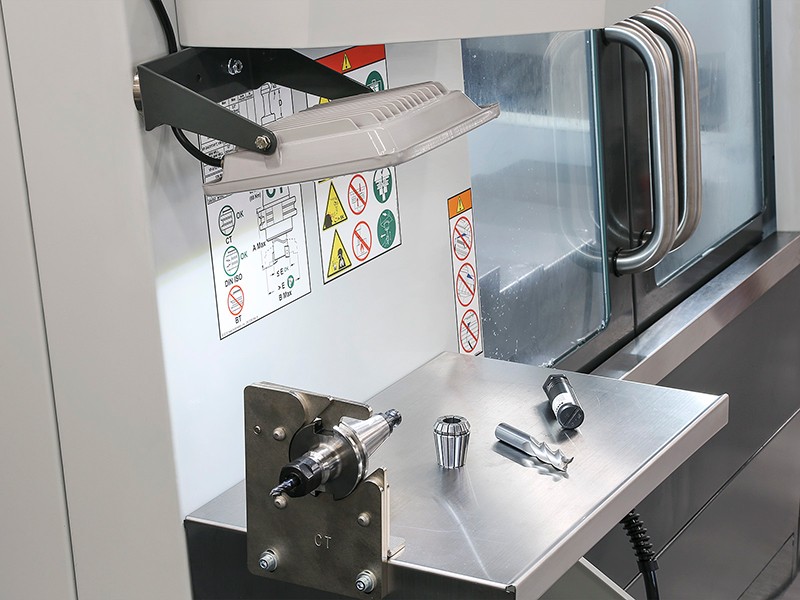

LED Writing Table Light Kit, 24VDC, for VF-6 TO VF-9
Part #: 93-1000514
VF-6 TO VF-9 24V WRITING TABLE KIT
Price: 195.95 ( / unit)
ATTENTION: This 24V LED light is for use on Haas machines with 24V lighting systems only.
This energy-efficient 30-watt LED lamp with bracket and magnetic mount attaches to the machine enclosure above the work table to provide bright illumination for inspecting tools, changing inserts, and more. The light is powered and controlled by the standard machine work light circuit, using a power splitter adapter included in the kit. For machines with 24V light systems only.
  • 30-watt LED illuminates the writing table
  • Energy efficient and cool running
  • Attaches easily with magnetic mount
  • For 24V systems only
