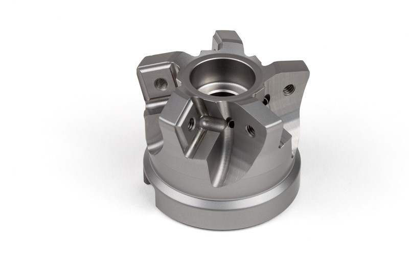

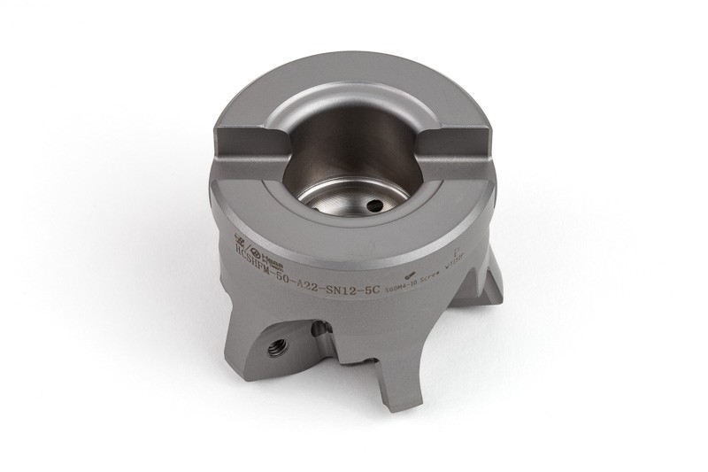

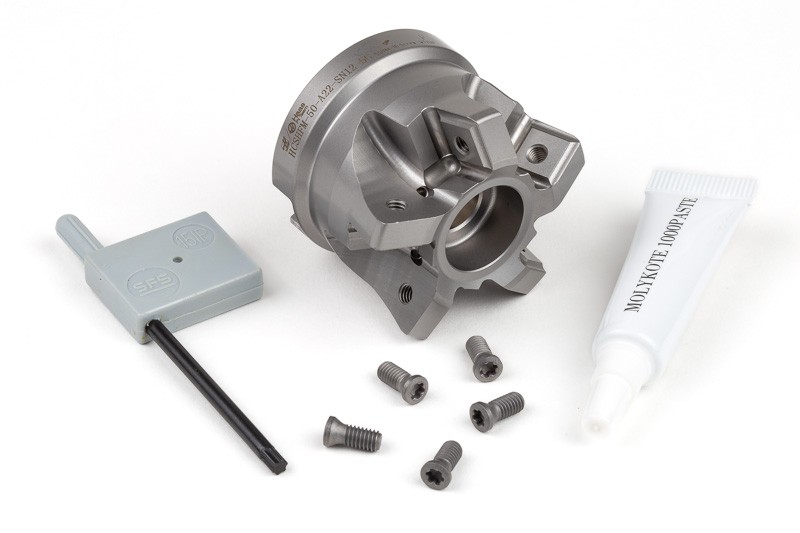

This Haas Double Square High Feed (HCSHF) medium-pitch shell mill is an economical, large-rake cutter with great vibration damping properties. The impact-resistant geometry allows for incredibly stable high-feed machining when axial plunge milling, copy milling, face milling, helical milling, and ramping. It has a 50mm cutting diameter, and a 22mm pilot bore, with a 17-degree cutting edge. The negative axial, negative radial-raked cutter body takes 5 square cutting inserts. The screw-clamp inserts have 8 cutting edges, and are available in grades for steel and stainless steel. This cutter body is through-tool coolant (TSC) capable, when used in conjunction with a coolant-through arbor screw. Inserts and coolant-through arbor screw sold separately.
[ØDC] Cutting Diameter 50.0 mm
Milling Cutter Series HCSHF - Haas Double Sq Hi Feed
Toolpath Type Ramping, Helical Milling, Axial Plunge Milling, Copy Milling, Face Milling
[°] Lead Angle 17 Degree
[Z] Number of Cutting Teeth 5
[Ød] Arbor Hole Diameter 22.0 mm
[E] Arbor Hole Depth 20.0 mm
[a] Keyway Width 10.4 mm
[b] Keyway Depth 7.1 mm
[Ap] Max. Cutting Depth 1.8 mm
[OAL] Overall Length 40.0 mm
[IC] Inscribed Circle Diameter 13.0 mm
[L10] Cutting Edge Length 12.7 mm
Maximum RPM 6200
Torque of Insert Screw 515 Ncm
Coupling Style A
Through Tool Coolant Yes
Weight 0.7 kg
