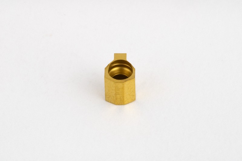

  • Technical Details
Tool Orientation Internal, External
Hand of Tool Neutral
Insert Style Keyway
Insert Size 2
[ØD] Min. Machining Diameter 0.276 in \ 7.0 mm
[ØDMM] Shank Diameter 0.9843 in \ 25.0 mm
[Ød3] Diameter 1.181 in \ 30.0 mm
[Ød2] Diameter 0.236 in \ 6.0 mm
[LS] Shank Length 3.54 in \ 90.0 mm
[LOC] Length Of Cut 0.98 in \ 25.0 mm
[OAL] Overall Length 4.88 in \ 124.0 mm
[S] Center to Insert Dimension 0.138 in \ 3.5 mm
Through Tool Coolant Yes
Country of Origin Italy
Weight 0.8 lbs \ 0.4 kg

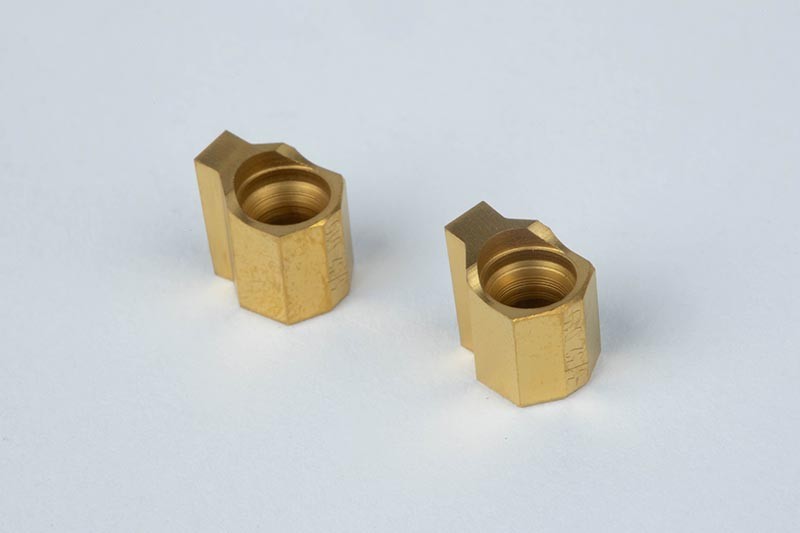

HIN, 2mm Keyway Broaching Insert, H7-SM Slip/Snug Fit, Size 2, TiN Coated - Pack of 2

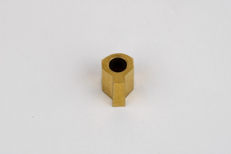

HIN, 2mm Keyway Broaching Insert, D10 Clearance Fit, Size 2, TiN Coated - Pack of 2

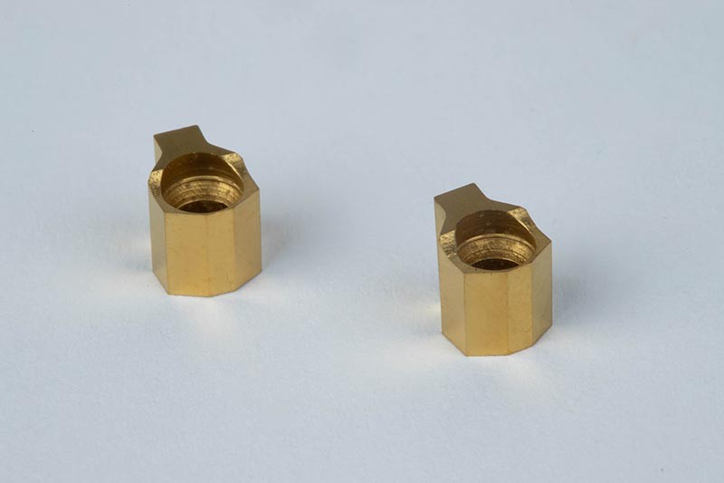

HIN, 3/32” Keyway Broaching Insert, P9 Interference Fit, Size 2, TiN Coated - Pack of 2

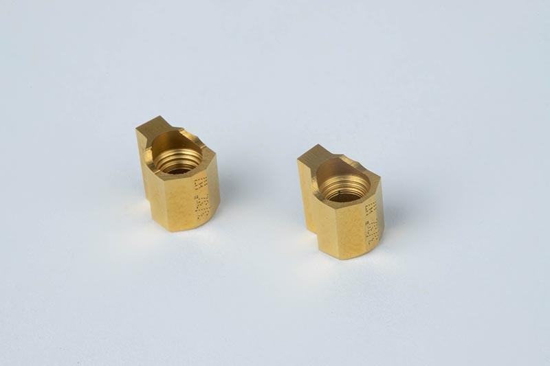

HIN, 3/32” Keyway Broaching Insert, H7 Slip/Snug Fit, Size 2, TiN Coated - Pack of 2
