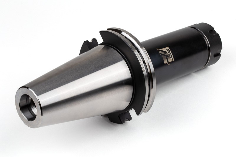

SK50 ER32 Collet Chuck x 160mm Gage Length, TSC
Part #: 04-1104
SK50-ER32-160
Price: 162.95 ( / unit)
Price: 3498.95 ( / unit)
Price: 1041.95 ( / unit)
Price: 139.95 ( / unit)
Price: 629.95 ( / unit)
Price: 1469.95 ( / unit)
89.97
2449.97
728.97
97.97
440.97
1028.97

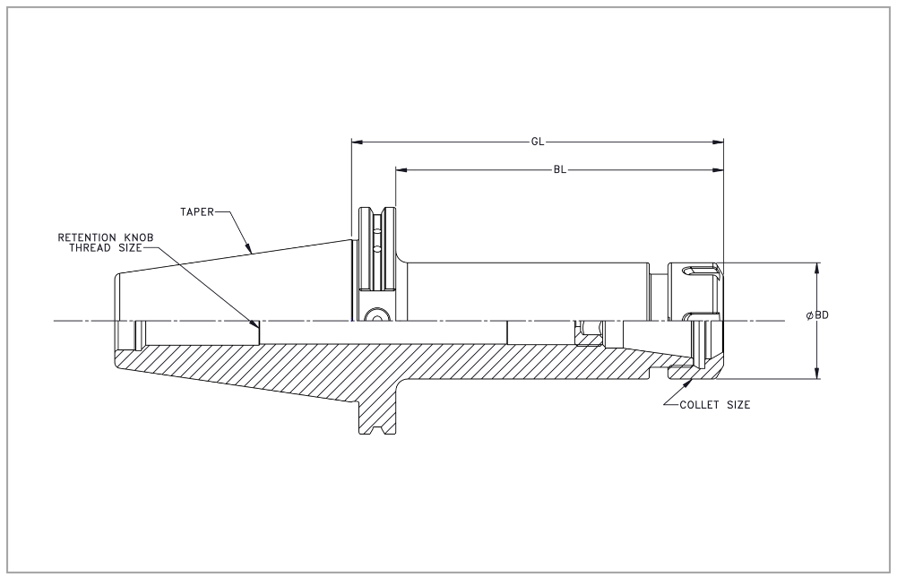

This SK50 \ DIN 69871 ER32 collet chuck accepts a variety of ER32 collet styles, and has a 160mm gage length. The double-taper collet design provides high clamping force for round, smooth shank tools, and offers a wide gripping range with excellent TIR and balance. It is through-tool coolant (TSC) capable, with a M24x3.0 pull stud/retention knob thread.
Taper SK50 \ DIN 69871
Collet Series ER-32
[ØBD] Body Diameter 50.0 mm
[GL] Gage Length 160.0 mm
[BL] Body Length 140.9 mm
Concentricity 0.003 mm
Balanced to RPM 20000
Retention Knob Thread Size M24X3.0
Through Tool Coolant Yes
Spindle Drive Slots Yes
Weight 9.5 lbs \ 4.3 kg
