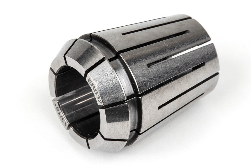

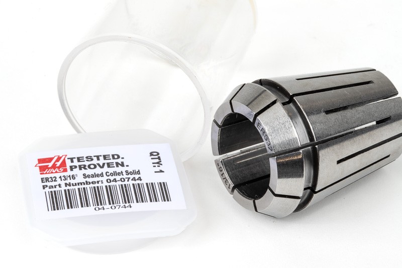

ER32 13/16" Straight-Bore Sealed Collet
Part #: 04-0744
ER32-13/16" SEALED COLLET
Price: 19.95 ( / unit)
12.97
This 0.8125 in \ 13/16" ER32 straight-bore sealed collet for 0.8125 in \ 13/16" round shank tools ensures that 100% of through-tool coolant (TSC) gets to the tip of the cutting tool. It has a 0.0004" TIR, and is defined by collet class 1, per DIN ISO 15488. This collet has no clamping range; the tool shank must be the exact diameter of the collet bore.
Collet Series ER-32
Collet Class Class 1
Type Straight Bore Sealed
[ØD] Bore Diameter 0.8125 in \ 13/16"
[MIN] Minimum Length 1.378 in
Total Indicator Runout (TIR) 0.0004 in
Weight 0.2 lbs \ 0.1 kg
