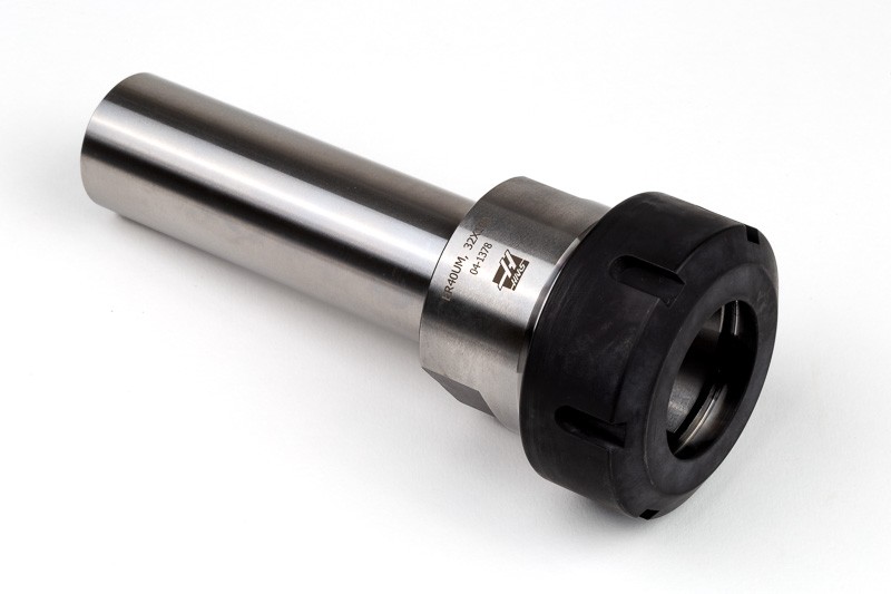

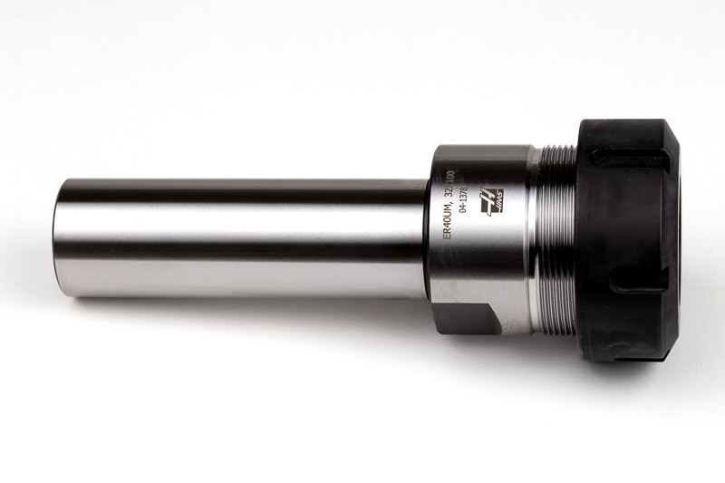

This straight shank ER40 collet chuck accepts a variety of ER40 collet styles, and has a 32mm shank. The precision cylindrical shank requires a milled flat to mount into any internal (ID) turning holder with the appropriate bore size and set-screw clamping. The double-taper collet design provides high clamping force for round, smooth shank tools, and offers a wide gripping range with excellent TIR and balance. The collet chuck is through-tool coolant (TSC) capable, and also may be used as an extended-length milling collet, by clamping it into the appropriate end mill holder.
Collet Series ER-40
[ØBD] Body Diameter 63.0 mm
[ØDMM] Shank Diameter 32.0 mm
[LS] Shank Length 100.0 mm
[LSCX] Maximum Clamping Length 155.0 mm
[OAL] Overall Length 160.0 mm
[FS] Flat Size 45.0 mm
[TP1] Thread M22.5x1.5
Concentricity 0.003 mm
Through Tool Coolant Yes
Weight 2.6 lbs \ 1.2 kg
