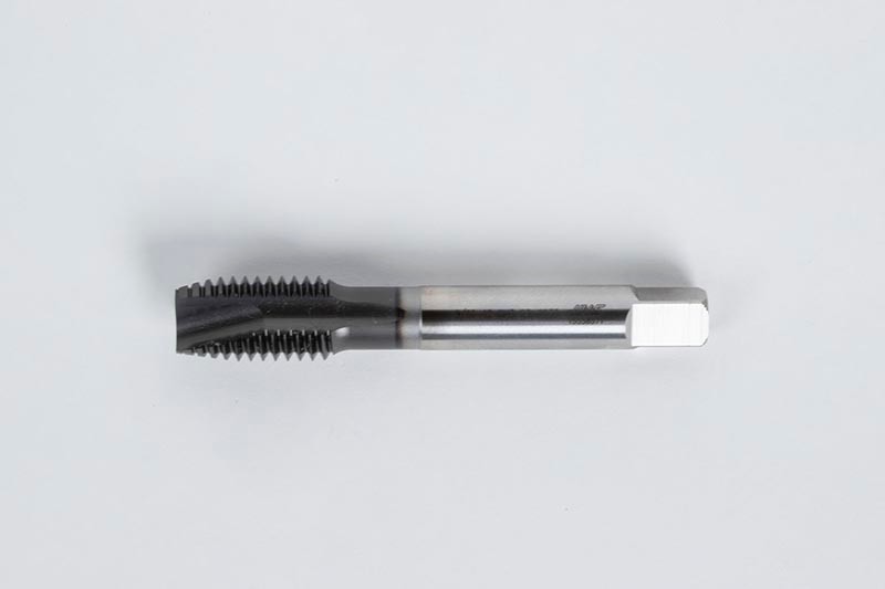

ER32 9/16" Tap Collet, 0.429" Bore Diameter x 0.322" Square
Part #: 04-0133
ER32-9/16" TAP COLLET 0.429" X 0.322"
Price: 26.95 ( / unit)
14.97
This ER32 tap collet for 9/16" taps has a 0.429" bore diameter and a 0.322" built-in square drive to securely grip flat-sided tap shanks, providing the extra torque required for tapping. It has a 0.0006" TIR, and is defined by collet class 1, per DIN ISO 15488. This collet has no clamping range; the tool shank must be the exact diameter of the collet bore.
Collet Series ER-32
Collet Class Class 1
Type Tap Collet
Tap Size 9/16"
[ØD] Bore Diameter 0.429 in
[LSC] Clamping Length 0.984 in
[SS] Square Size 0.322 in
Total Indicator Runout (TIR) 0.0006 in
Weight 0.3 lbs \ 0.1 kg

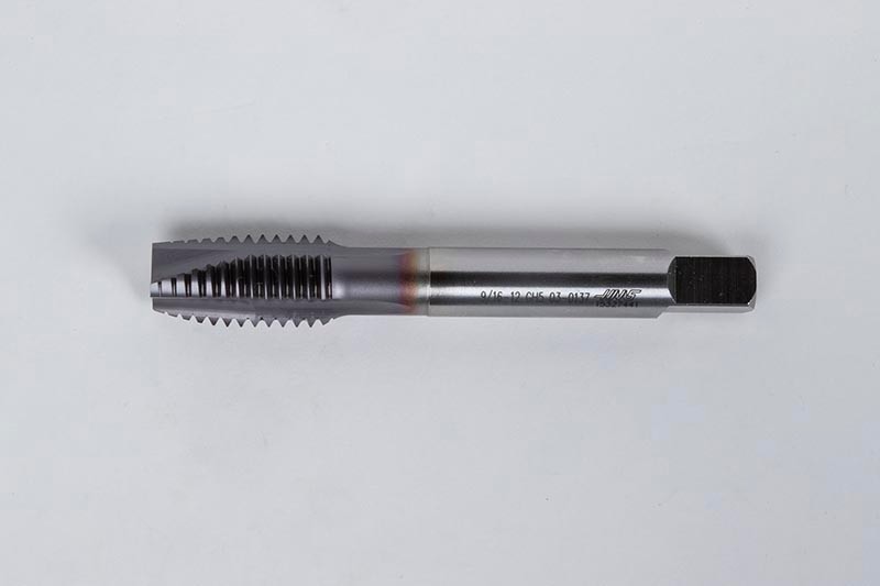

9/16"-12 UNC HSS-E Spiral Point Tap, 0.429" Shank x 0.984" Thread Length, 3XD, Plug, 3 Flute, GH5, TiCN Coated
