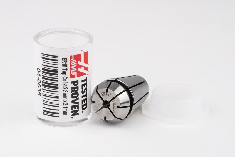

This ER16 tap collet for M2 to M4 taps has a 2.8mm bore diameter and a 2.1mm built-in square drive to securely grip flat-sided tap shanks, providing the extra torque required for tapping. It has a 0.015mm TIR, and is defined by collet class 2, per DIN ISO 15488. This collet has no clamping range; the tool shank must be the exact diameter of the collet bore.
Collet Series ER-16
Collet Class Class 2
Type Tap Collet
Tap Size M2 - M4
[ØD] Bore Diameter 2.8 mm
[LSC] Clamping Length 17.0 mm
[SS] Square Size 2.1 mm
Total Indicator Runout (TIR) 0.015 mm
