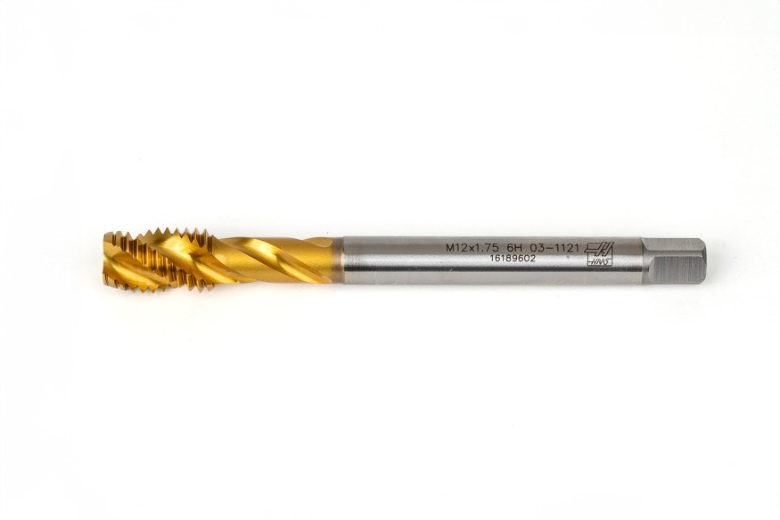

M12x1.75 M HSS-E Spiral Flute Tap, 9mm Shank x 18mm Thread Length, 2.5XD, Mod. Bottoming, 3 Flute, 6H, TiN Coated
Part #: 03-1121
RETAIL PRICE:
15.97

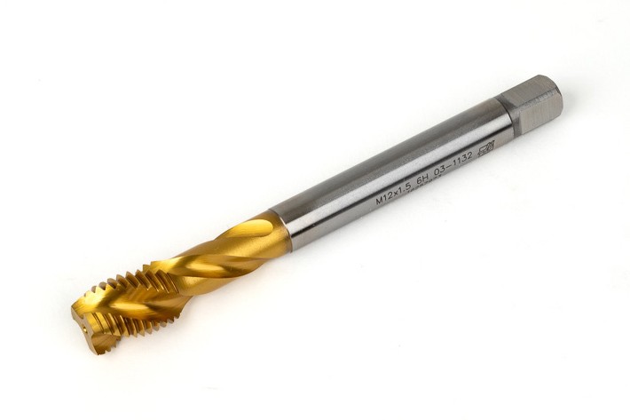

M12x1.5 MF HSS-E Spiral Flute Tap, 9mm Shank x 15mm Thread Length, 2.5XD, Mod. Bottoming, 3 Flute, 6H, TiN Coated
Part #: 03-1132
RETAIL PRICE:
15.97

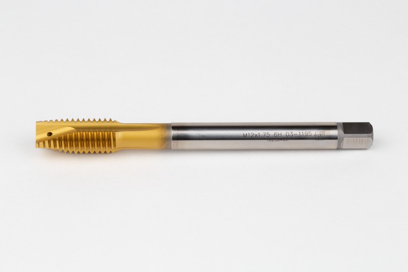

M12x1.75 M HSS-E Spiral Point Tap, 9mm Shank x 24mm Thread Length, 3XD, Plug, 3 Flute, 6H, TiN Coated
Part #: 03-1148
RETAIL PRICE:
15.97

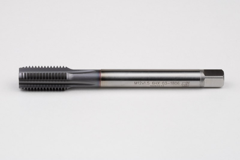

M12x1.5 MF HSS-E Straight Flute Tap, 9mm Shank x 22mm Thread Length, 2XD, Mod. Bottoming, 4 Flute, 6HX, TiCN Coated
Part #: 03-1806
RETAIL PRICE:
21.97
