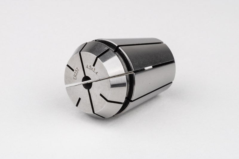

This ER25 tap collet for M4 to M6 taps has a 4.5mm bore diameter and a 3.4mm built-in square drive to securely grip flat-sided tap shanks, providing the extra torque required for tapping. It has a 0.015mm TIR, and is defined by collet class 2, per DIN ISO 15488. This collet has no clamping range; the tool shank must be the exact diameter of the collet bore.
Collet Series ER-25
Collet Class Class 2
Type Tap Collet
Tap Size M4 - M6
[ØD] Bore Diameter 4.5 mm
[LSC] Clamping Length 20.0 mm
[SS] Square Size 3.4 mm
Total Indicator Runout (TIR) 0.015 mm
Weight 0.2 lbs \ 0.1 kg
