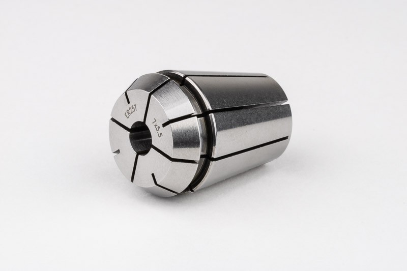

This ER25 tap collet for M7 to M10 taps has a 7mm bore diameter and a 5.5mm built-in square drive to securely grip flat-sided tap shanks, providing the extra torque required for tapping. It has a 0.015mm TIR, and is defined by collet class 2, per DIN ISO 15488. This collet has no clamping range; the tool shank must be the exact diameter of the collet bore.
Collet Series ER-25
Collet Class Class 2
Type Tap Collet
Tap Size M7 - M10
[ØD] Bore Diameter 7.0 mm
[LSC] Clamping Length 22.0 mm
[SS] Square Size 5.5 mm
Total Indicator Runout (TIR) 0.015 mm
Weight 0.2 lbs \ 0.1 kg
