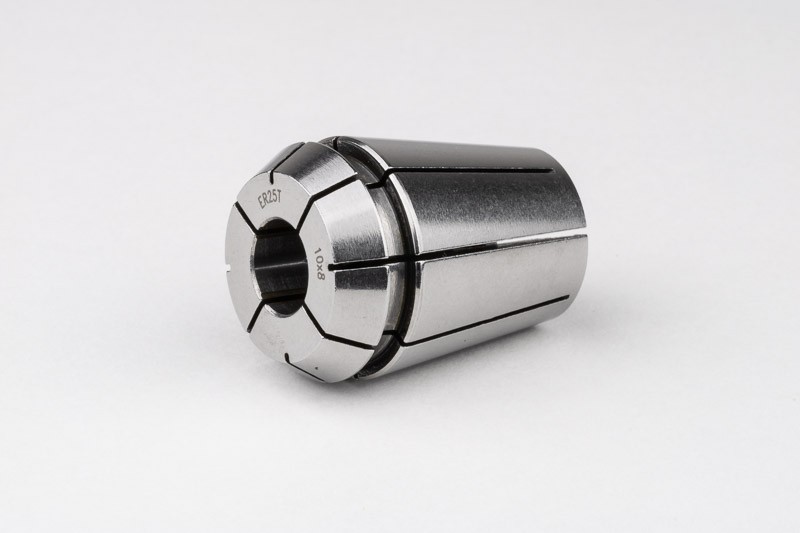

ER25 M10 Tap Collet, 10mm Bore Diameter x 8mm Square
Part #: 04-0651
ER25-M10 TAP COLLET 10MM X 8MM

This ER25 tap collet for M10 taps has a 10mm bore diameter and a 8mm built-in square drive to securely grip flat-sided tap shanks, providing the extra torque required for tapping. It has a 0.015mm TIR, and is defined by collet class 2, per DIN ISO 15488. This collet has no clamping range; the tool shank must be the exact diameter of the collet bore.
Collet Series ER-25
Collet Class Class 2
Type Tap Collet
Tap Size M10
[ØD] Bore Diameter 10.0 mm
[LSC] Clamping Length 23.0 mm
[SS] Square Size 8.0 mm
Total Indicator Runout (TIR) 0.015 mm
Weight 0.2 lbs \ 0.1 kg
