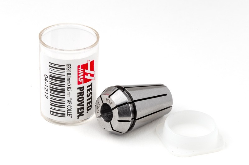

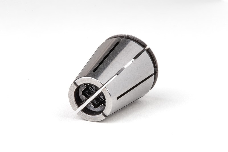

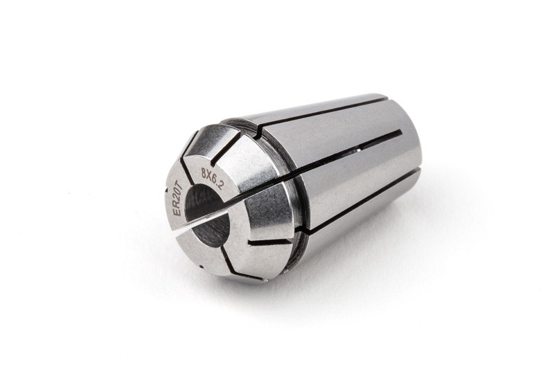

This ER20 tap collet for M8 to M11 taps has a 8mm bore diameter and a 6.2mm built-in square drive to securely grip flat-sided tap shanks, providing the extra torque required for tapping. It has a 0.015mm TIR, and is defined by collet class 2, per DIN ISO 15488. This collet has no clamping range; the tool shank must be the exact diameter of the collet bore.
Collet Series ER-20
Collet Class Class 2
Type Tap Collet
Tap Size M8 - M11
[ØD] Bore Diameter 8.0 mm
[LSC] Clamping Length 20.0 mm
[SS] Square Size 6.2 mm
Total Indicator Runout (TIR) 0.015 mm
Weight 0.07 lbs \ 0.03 kg
