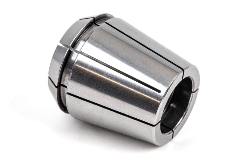

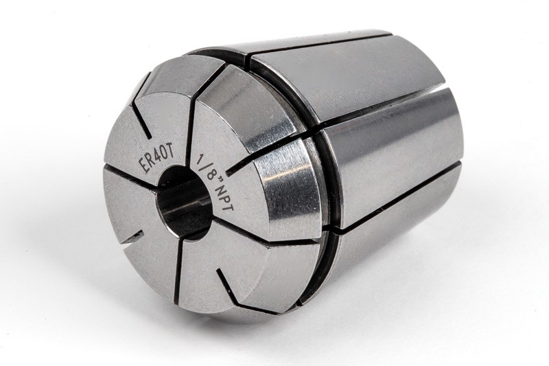

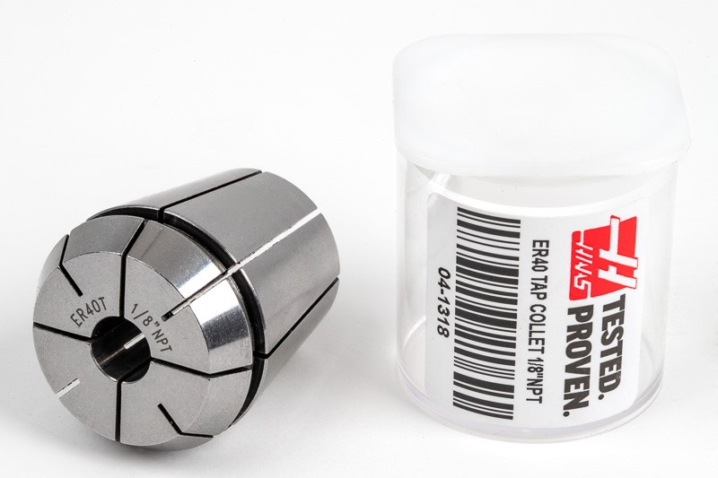

ER40 1/8" NPT Tap Collet, 0.438" Bore Diameter x 0.328" Square
Part #: 04-1318
ER40-1/8" NPT TAP COLLET 0.438" X 0.328"
Price: 29.95 ( / unit)
16.97
This ER40 tap collet for 1/8" NPT taps has a 0.438" bore diameter and a 0.328" built-in square drive to securely grip flat-sided tap shanks, providing the extra torque required for tapping. It has a 0.0006" TIR, and is defined by collet class 1, per DIN ISO 15488. This collet has no clamping range; the tool shank must be the exact diameter of the collet bore.
Collet Series ER-40
Collet Class Class 1
Type Tap Collet
Tap Size 1/8" NPT
[ØD] Bore Diameter 0.438 in
[LSC] Clamping Length 1.063 in
[SS] Square Size 0.328 in
Total Indicator Runout (TIR) 0.0006 in
Weight 0.7 lbs \ 0.3 kg
