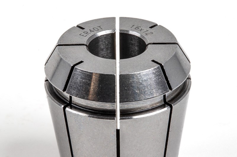

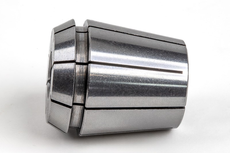

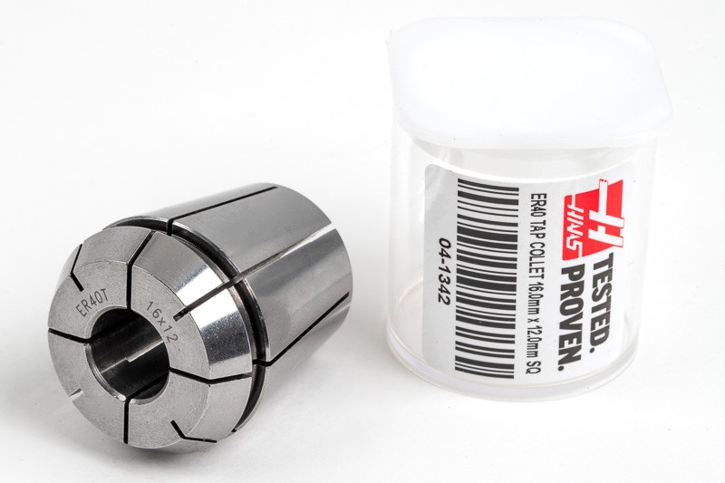

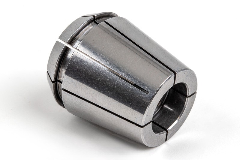

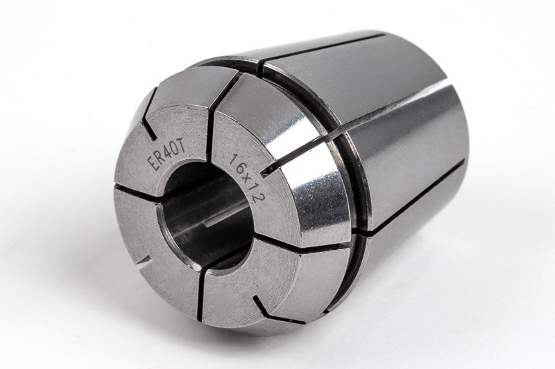

ER40 M20 Tap Collet, 16mm Bore Diameter x 12mm Square
Part #: 04-1342
ER40-M20 TAP COLLET 16MM X 12MM
Price: 29.95 ( / unit)
Price: 623.95 ( / unit)
Price: 185.95 ( / unit)
Price: 24.95 ( / unit)
Price: 112.95 ( / unit)
Price: 261.95 ( / unit)
14.97
324.97
96.97
12.97
58.97
136.97
This ER40 tap collet for M20 taps has a 16mm bore diameter and a 12mm built-in square drive to securely grip flat-sided tap shanks, providing the extra torque required for tapping. It has a 0.015mm TIR, and is defined by collet class 1, per DIN ISO 15488. This collet has no clamping range; the tool shank must be the exact diameter of the collet bore.
Collet Series ER-40
Collet Class Class 1
Type Tap Collet
Tap Size M20
[ØD] Bore Diameter 16.0 mm
[LSC] Clamping Length 28.0 mm
[SS] Square Size 12.0 mm
Total Indicator Runout (TIR) 0.015 mm
Weight 0.5 lbs \ 0.2 kg
