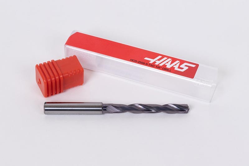

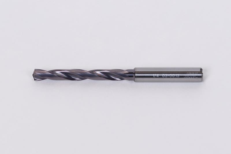

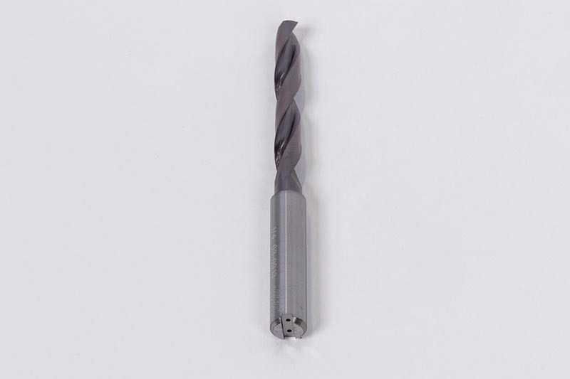

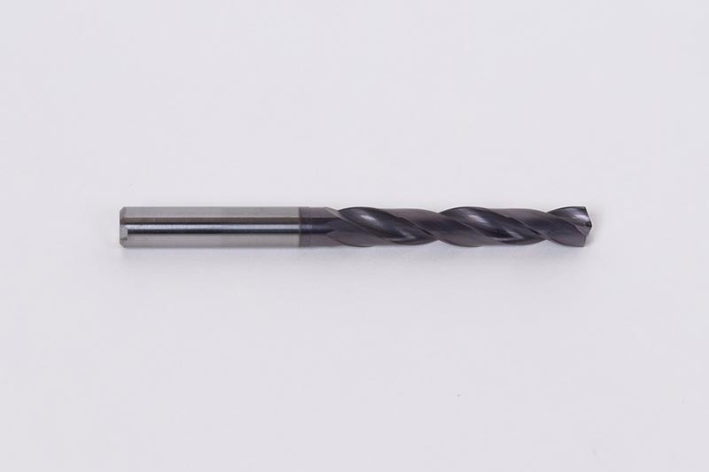

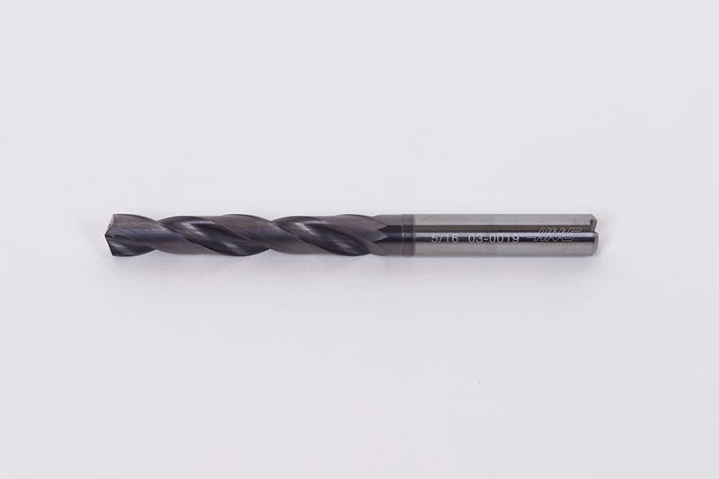

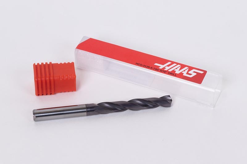

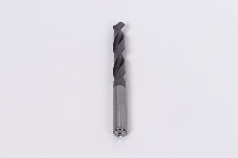

5/16" Ø Carbide Drill, 8mm Shank x 140° Point Angle x 30° Helix, 5XD, 2 Flute, TiAlN Coated, GP, TSC
Part #: 03-0019
HCD-3125-5-TSC 5/16" DRILL
Price: 67.95 ( / unit)
44.97
ISO MATERIAL CHART
Drill Type Fraction
[D1] Drill Diameter 0.3125 in \ 5/16"
Secondary Workpiece Material M - Stainless Steel, H - Hardened Materials
Material Carbide
Coating TiAlN
[ØDMM] Shank Diameter 0.315 in \ 8.0 mm
[LU] Usable Length 1.693 in
[LCF] Flute Length 2.087 in
[PL] Point Length 0.039 in
[OAL] Overall Length 3.583 in
[NOF] Number of Flutes 2
[SIG°] Point Angle 140
[FHA°] Helix Angle 30
Length / Diameter 5 X D
Hole Tolerance m7
Cutting Direction Right
Through Spindle Coolant Yes
