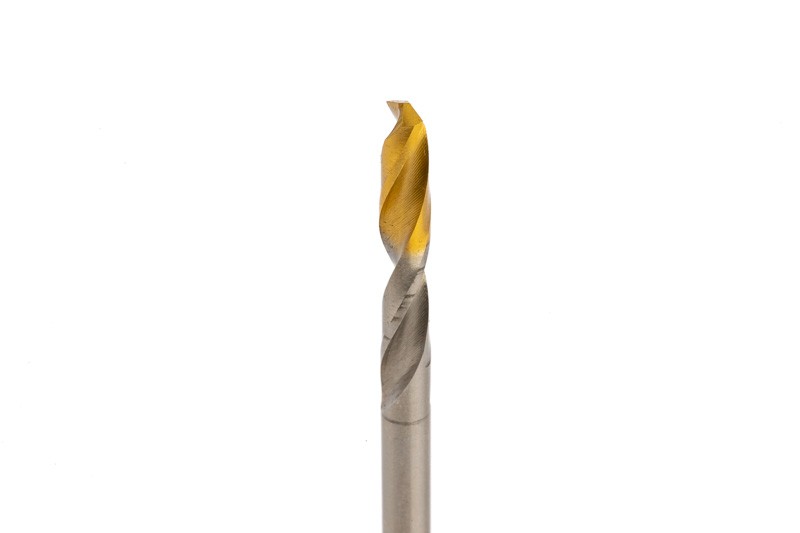

#21 Ø Cobalt Stub Drill, 135° Point Angle x 30° Helix, 2 Flute, TiN Coated - Pack of 10
Part #: 03-2363
CB SBD 2FL #21X.159X1-1/16X2-1/8,TIN
Price: 18.95 ( / unit)
11.97
ISO MATERIAL CHART
Drill Type Number
Primary Workpiece Material M - Stainless Steel, P - Steel
Secondary Workpiece Material K - Cast Iron, S - High Temp Alloys, N - Aluminum
Material HSSCo8 (M42)
Coating TiN
[D1] Drill Diameter 0.159 in \ #21
[ØDMM] Shank Diameter 0.159 in
[LU] Usable Length 0.936 in
[LCF] Flute Length 1.063 in
[PL] Point Length 0.033 in
[OAL] Overall Length 2.125 in
[NOF] Number of Flutes 2
[SIG°] Point Angle 135
[FHA°] Helix Angle 30
Drill Length Type Stub
Hole Tolerance h8
Cutting Direction Right
Through Spindle Coolant No
