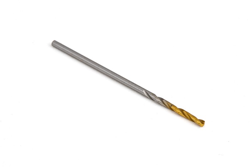

#59 Ø Cobalt Stub Drill, 135° Point Angle x 30° Helix, 2 Flute, TiN Coated - Pack of 10
Part #: 03-2401
CB SBD 2FL #59x.041x1/2x1-3/8,TIN
Price: 11.95 ( / unit)
7.97
ISO MATERIAL CHART
Drill Type Number
Secondary Workpiece Material K - Cast Iron, S - High Temp Alloys, N - Aluminum
Material HSSCo8 (M42)
Coating TiN
[D1] Drill Diameter 0.041 in \ #59
[ØDMM] Shank Diameter 0.041 in
[LU] Usable Length 0.468 in
[LCF] Flute Length 0.5 in
[PL] Point Length 0.009 in
[OAL] Overall Length 1.375 in
[NOF] Number of Flutes 2
[SIG°] Point Angle 135
[FHA°] Helix Angle 30
Drill Length Type Stub
Hole Tolerance h8
Cutting Direction Right
Through Spindle Coolant No
