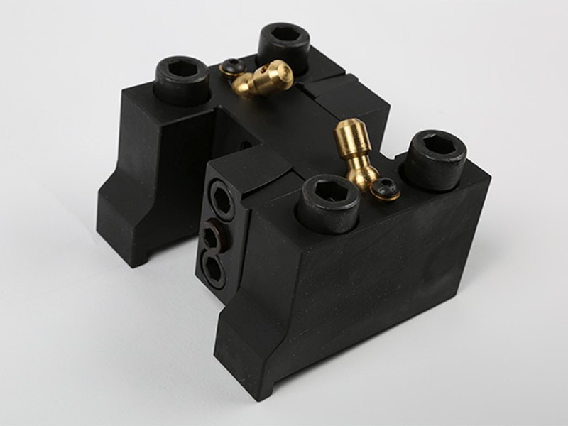

BOT20, 1" Square Shank External (OD) Twin Static Turning Holder
Part #: 04-0761
BOT20OD-1T
Price: 635.95 ( / unit)
This BOT20 external (OD) twin static turning holder securely clamps 1.0 in \ 1" square shank tools for use in Haas machines equipped with 12-station VB20/30 hybrid (BOT20/VDI40) turrets.
**This holder is only suitable for 12-station VB20/30 hybrid (BOT20/VDI40) turrets, and will NOT fit 12-station BOT20 bolt-on turrets.

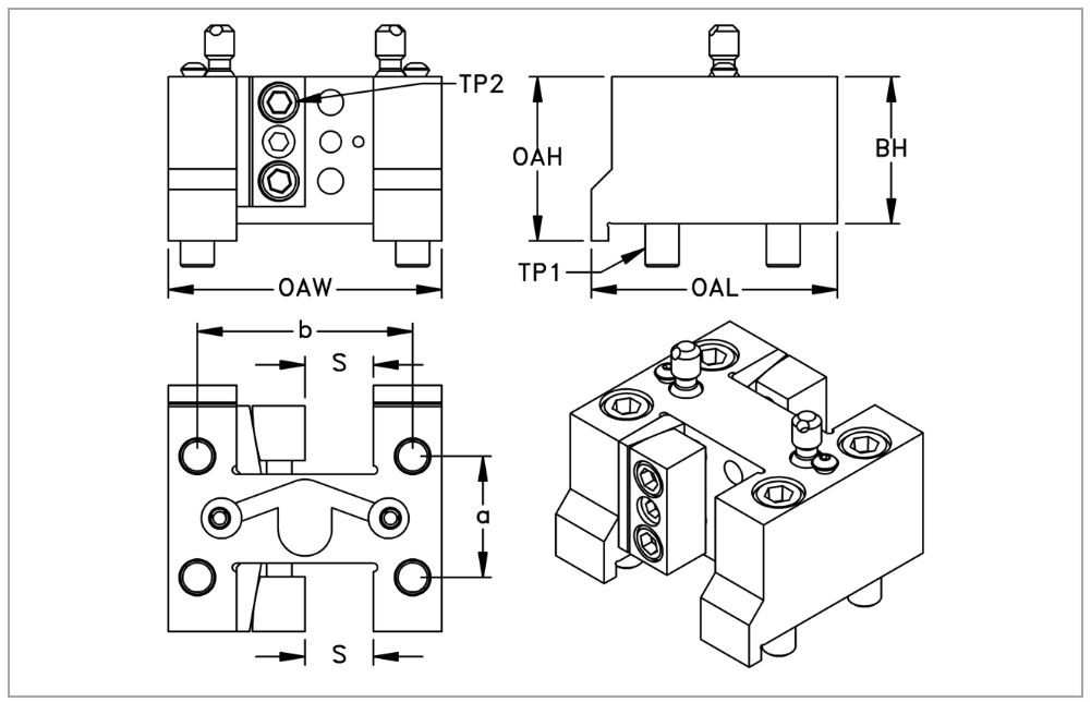

[S] Tool Shank Size 1.0 in \ 1"
[BH] Body Height 2.15 in
[OAL] Overall Length 3.6 in
[OAW] Overall Width 4.0 in
[OAH] Overall Height 2.4 in
[a] Dimension 1.772 in
[b] Dimension 3.15 in
[TP1] Thread 1/2"-13
[TP2] Thread 3/8"-16
Weight 6.0 lbs \ 2.7 kg
