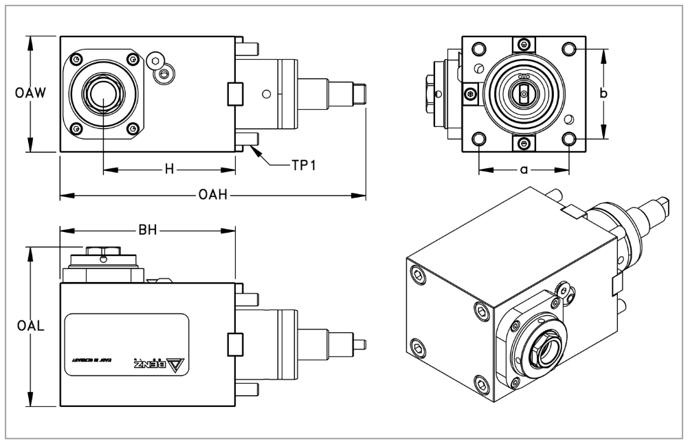

This BMT45 ER20 90-degree radial live/driven turning holder by BENZ accepts a variety of ER20 collet styles, for use in Haas machines equipped with 12-station or 24-station BMT45 base mount turrets. The double-taper collet design provides high clamping force for round, smooth shank tools, and offers a wide gripping range with excellent TIR and balance.
  • Driven (Live) Tool Heads
  • Warranty Information
System of Measurement Inch - ANSI, Metric - ISO
Machine Models ST-15LY, ST-10LY, ST-15Y, ST-10Y
Turret Style Base Mount
Turret Stations 12-Station, 24-Station
Main Spindle Turret BMT45
Sub-Spindle Turret BMT45
Toolholder Series BMT45
Holder Type 90-Degree
Collet Series ER-20
[H] Height 3.346 in / 85.0 mm
[BH] Body Height 4.449 in / 113.0 mm
[OAL] Overall Length 4.055 in / 103.0 mm
[OAW] Overall Width 2.953 in / 75.0 mm
[OAH] Overall Height 7.756 in / 197.0 mm
[a] Dimension 2.283 in / 58.0 mm
[b] Dimension 2.283 in / 58.0 mm
[TP1] Thread M8x1.25
Maximum RPM 6000
Brand BENZ Tooling
Weight 12.0 lbs \ 5.4 kg
Country of Origin Germany
