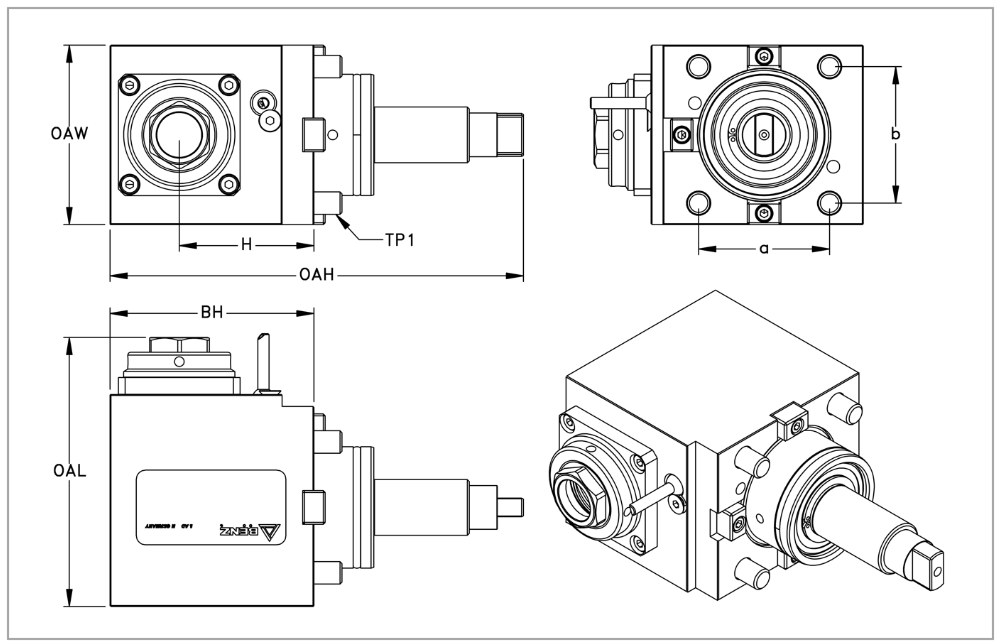

This BMT65 ER32 90-degree radial live/driven turning holder by BENZ accepts a variety of ER32 collet styles, for use in Haas machines equipped with 12-station or 24-station BMT65 base mount turrets. The double-taper collet design provides high clamping force for round, smooth shank tools, and offers a wide gripping range with excellent TIR and balance.
  • Driven (Live) Tool Heads
  • Warranty Information
System of Measurement Inch - ANSI, Metric - ISO
Machine Models ST-20LY, ST-30L, ST-28Y, ST-35LY, ST-28LY, ST-35L, ST-25LY, ST-30LY, ST-25L, ST-28L, ST-25Y, ST-28, ST-30Y, ST-20L, DS-30Y, ST-30, ST-35Y, ST-25, ST-35, ST-20Y, ST-20
Turret Style Base Mount
Turret Stations 12-Station, 24-Station
Main Spindle Turret BMT65
Sub-Spindle Turret BMT65
Toolholder Series BMT65
Holder Type 90-Degree
Collet Series ER-32
[H] Height 2.835 in / 72.0 mm
[BH] Body Height 4.291 in / 109.0 mm
[OAL] Overall Length 5.665 in / 143.9 mm
[OAW] Overall Width 3.78 in / 96.0 mm
[OAH] Overall Height 8.701 in / 221.0 mm
[a] Dimension 2.756 in / 70.0 mm
[b] Dimension 2.874 in / 73.0 mm
[TP1] Thread M12x1.75
Maximum RPM 6000
Brand BENZ Tooling
Weight 14.1 lbs \ 6.4 kg
Country of Origin Germany
