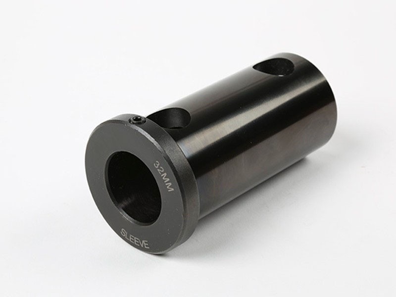

This LB-type reduction sleeve/bushing has a 50mm shank, and is used to expand the working range of your turning holders by securely clamping on smaller, 20mm round shank, internal (ID) turning tools. It is black oxide coated, for improved corrosion resistance.
Please note: The reduction sleeves shank length [LS] may be too long for through-tool coolant applications on some holders.
Type LB
Coating Black Oxide
[ØDMM] Shank Diameter 50.0 mm
[ØD] Bore Diameter 20.0 mm
[Ød1] Diameter 60.0 mm
[Ød2] Diameter 19.05 mm
[LS] Shank Length 100.0 mm
[OAL] Overall Length 109.54 mm
[a] Dimension 69.85 mm
[b] Dimension 12.7 mm
Screw M6-1.0
Weight 1.0 lbs \ 0.5 kg
Country of Origin USA
