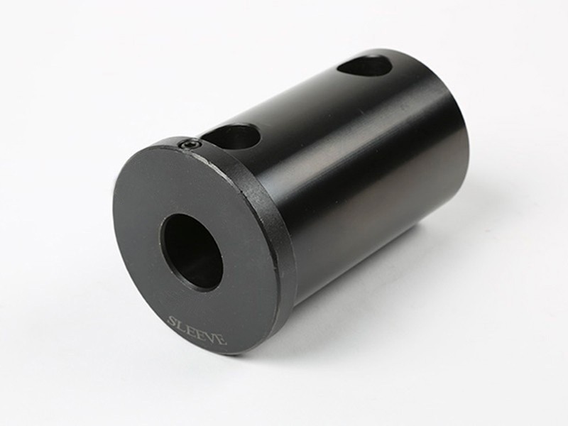

LB-Type Reduction Sleeve, 2-1/2" Shank x 1" Bore
Part #: 04-0081
BS1
Price: 209.95 ( / unit)
94.97
This LB-type reduction sleeve/bushing has a 2.5 in \ 2-1/2" shank, and is used to expand the working range of your turning holders by securely clamping on smaller, 1.0 in \ 1" round shank, internal (ID) turning tools. It is black oxide coated, for improved corrosion resistance.
Please note: The reduction sleeves shank length [LS] may be too long for through-tool coolant applications on some holders.
Type LB
Coating Black Oxide
[ØDMM] Shank Diameter 2.5 in \ 2-1/2"
[ØD] Bore Diameter 1.0 in \ 1"
[Ød1] Diameter 2.8 in
[Ød2] Diameter 0.75 in
[LS] Shank Length 3.938 in
[OAL] Overall Length 4.313 in
[a] Dimension 2.75 in
[b] Dimension 0.5 in
Screw 1/4"-20
Weight 1.0 lbs \ 0.5 kg
Country of Origin USA
