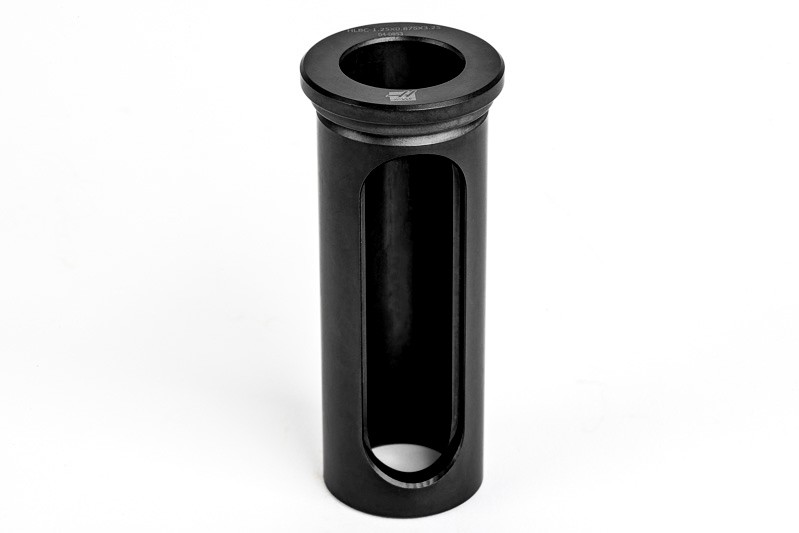

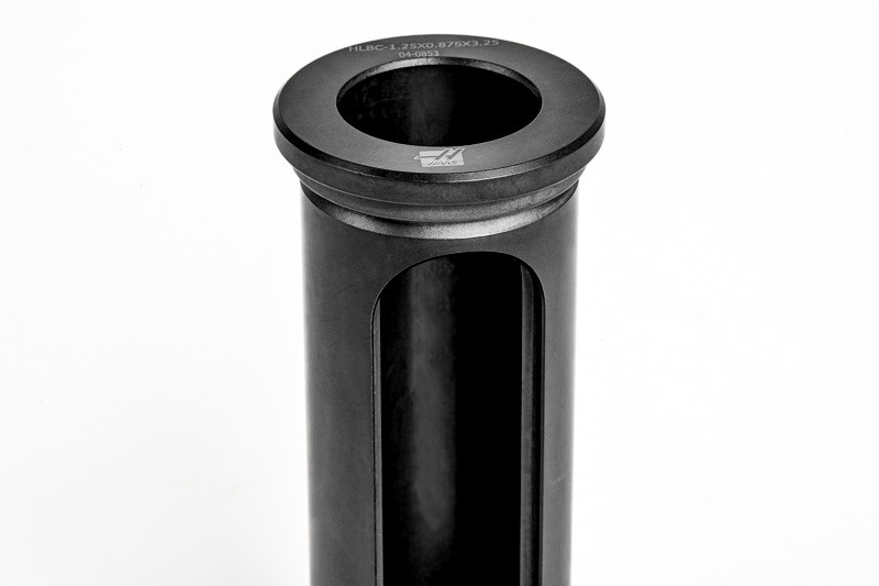

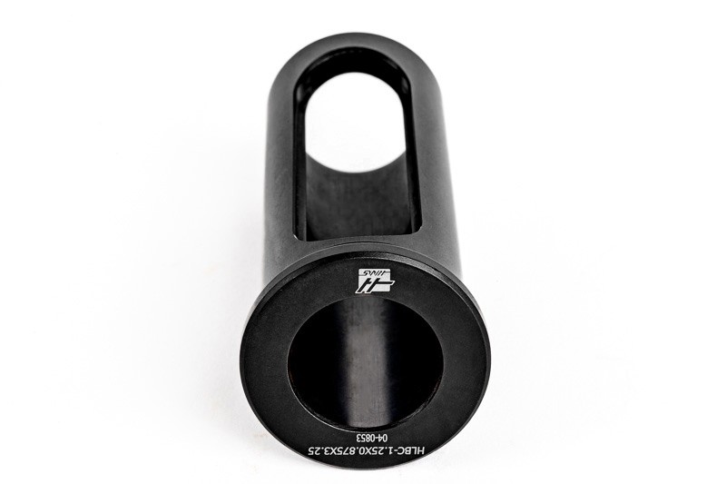

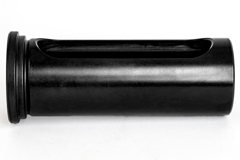

C-Type Reduction Sleeve, 1-1/4" Shank x 7/8" Bore
Part #: 04-0853
HLBC-1.25X0.875X3.25
Price: 68.95 ( / unit)
34.97
This C-type reduction sleeve/bushing has a 1.25 in \ 1-1/4" shank, and is used to expand the working range of your turning holders by securely clamping on smaller, 0.875 in \ 7/8" round shank, internal (ID) turning tools. It is black oxide coated, for improved corrosion resistance.
Please note: The reduction sleeves shank length [LS] may be too long for through-tool coolant applications on some holders.
Type C
Coating Black Oxide
[ØDMM] Shank Diameter 1.25 in \ 1-1/4"
[ØD] Bore Diameter 0.875 in \ 7/8"
[Ød1] Diameter 1.469 in
[LS] Shank Length 3.25 in
[OAL] Overall Length 3.515 in
[W] Width 0.75 in
[a] Dimension 2.0 in
[b] Dimension 0.562 in
Weight 0.5 lbs \ 0.2 kg
