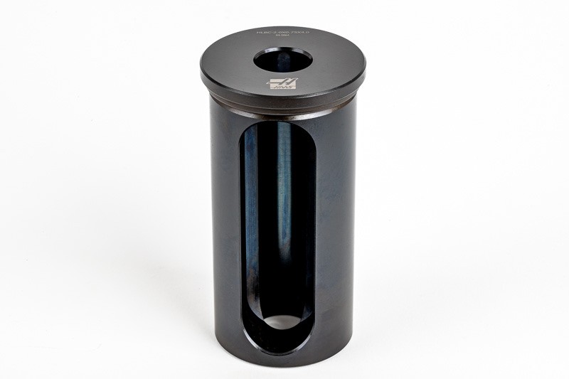

C-Type Reduction Sleeve, 2" Shank x 3/4" Bore
Part #: 04-0864
HLBC-2.0X0.75X4.0
Price: 83.95 ( / unit)
41.97
This C-type reduction sleeve/bushing has a 2.0 in \ 2" shank, and is used to expand the working range of your turning holders by securely clamping on smaller, 0.75 in \ 3/4" round shank, internal (ID) turning tools. It is black oxide coated, for improved corrosion resistance.
Please note: The reduction sleeves shank length [LS] may be too long for through-tool coolant applications on some holders.
Type C
Coating Black Oxide
[ØDMM] Shank Diameter 2.0 in \ 2"
[ØD] Bore Diameter 0.75 in \ 3/4"
[Ød1] Diameter 2.219 in
[LS] Shank Length 4.0 in
[OAL] Overall Length 4.303 in
[W] Width 1.0 in
[a] Dimension 2.625 in
[b] Dimension 0.625 in
Weight 1.0 lbs \ 0.5 kg
