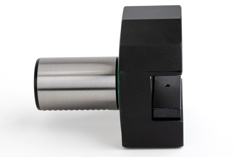

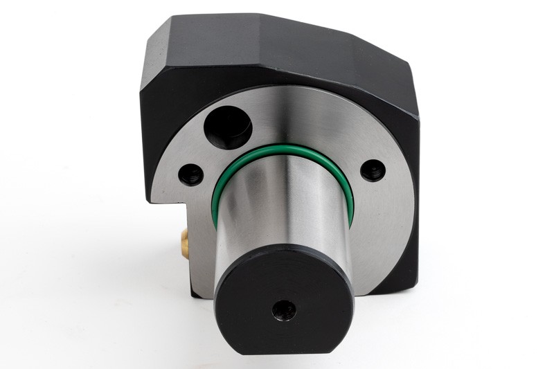

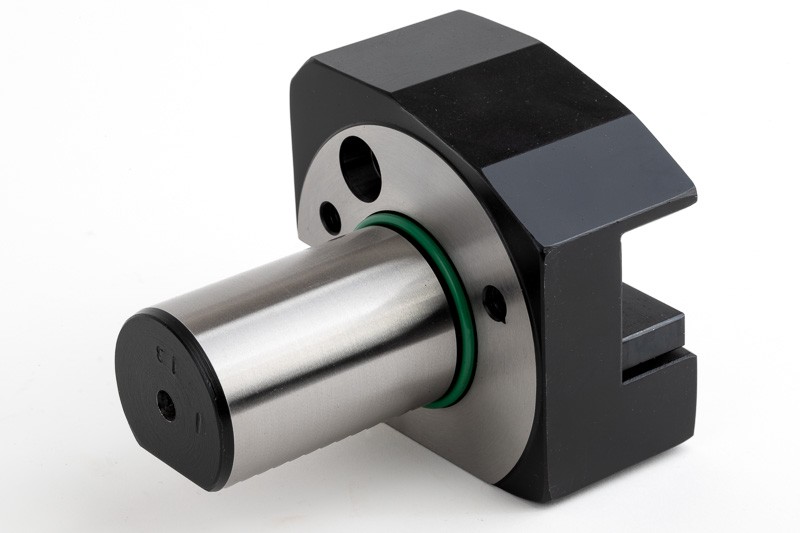

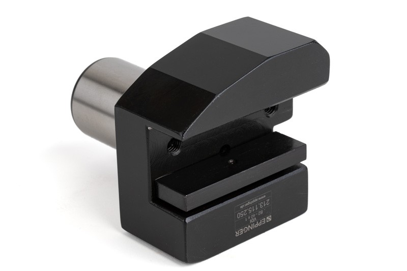

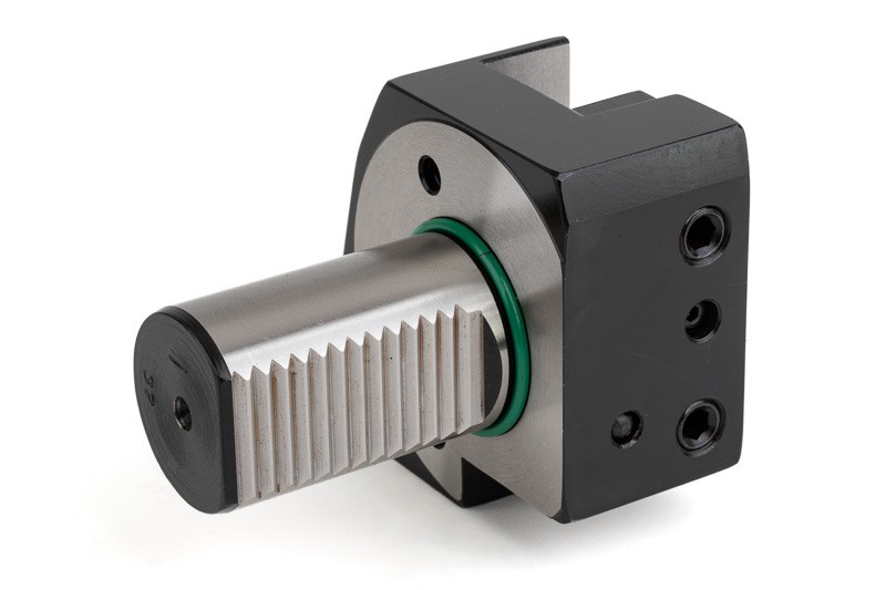

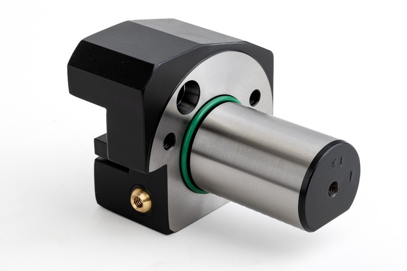

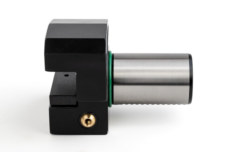

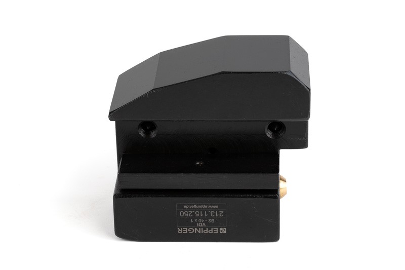

VDI40, 1" Square Shank External (OD) Static Turning Holder
Part #: 04-0999
VDI40OD-1-SHORT
Price: 288.95 ( / unit)
130.97
This VDI40 \ DIN 69880 external (OD) static turning holder securely clamps 1.0 in \ 1" square shank tools for use in Haas machines equipped with 12-station VDI40, 12-station VB10 hybrid (BOT10/VDI40), 12-station VB20/30 hybrid (BOT20/VDI40), 12-station VB40 hybrid (BOT40/VDI40), or 24-station VB24 (VB3024) hybrid (BOT24/VDI40) turrets.
Machine Models ST-30Y, ST-30, ST-15LY, ST-10LY, ST-10L, ST-15L, ST-35L, ST-30L, ST-15, ST-30SS, ST-20SS, ST-40L, ST-40, ST-30SSY, ST-20Y, ST-10Y, ST-20, ST-35Y, ST-28, ST-25Y, ST-28L, ST-35, ST-20L, DS-30SS, ST-25, ST-15Y, ST-45, ST-10, ST-45L, DS-30SSY, ST-20SSY
Turret Style VDI, VB Hybrid
Turret Stations 12-Station, 24-Station
Main Spindle Turret VB24 (VB3024), VB40, VB20/30, VB10, VDI40
Toolholder Series VDI40
Holder Type External Turning
[S] Tool Shank Size 1.0 in \ 1"
[ØDMM] Shank Diameter 1.575 in
[BL] Body Length 1.732 in
[OAL] Overall Length 4.213 in
[OAW] Overall Width 3.346 in
[OAH] Overall Height 3.169 in
Weight 7.0 lbs \ 3.2 kg
Country of Origin USA
