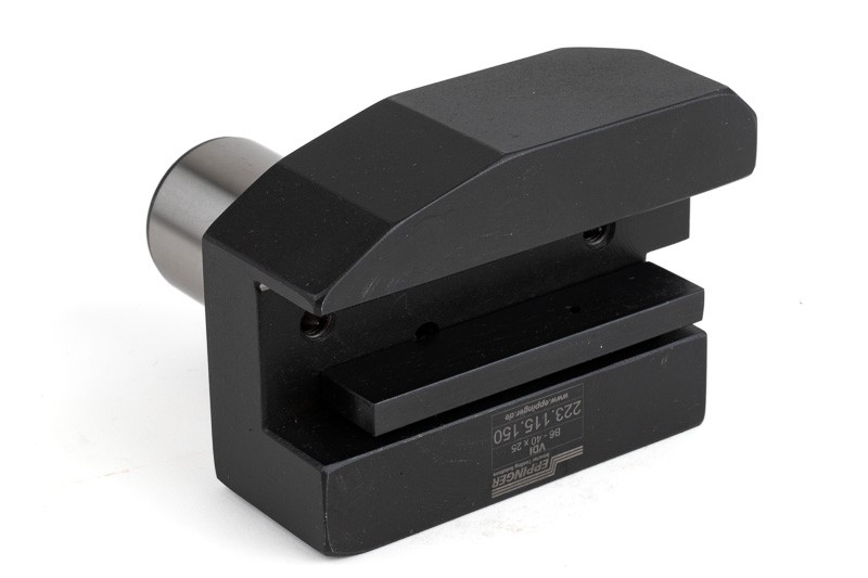

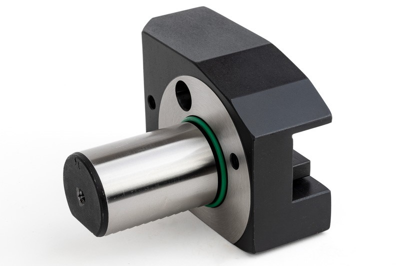

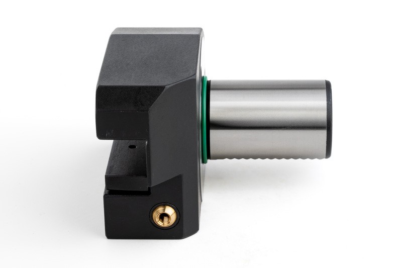

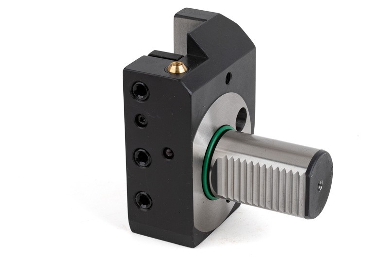

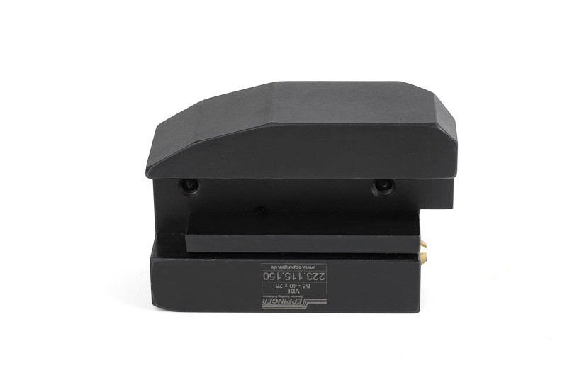

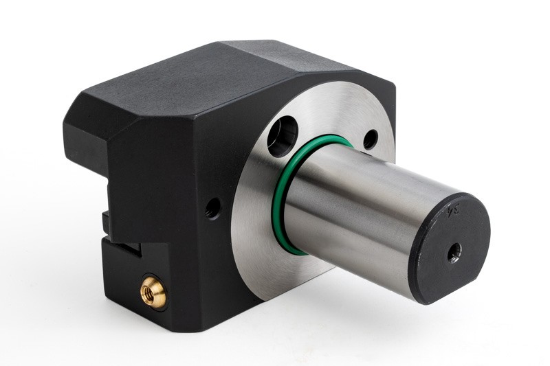

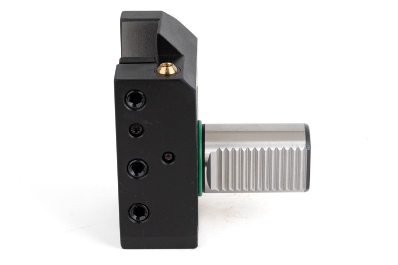

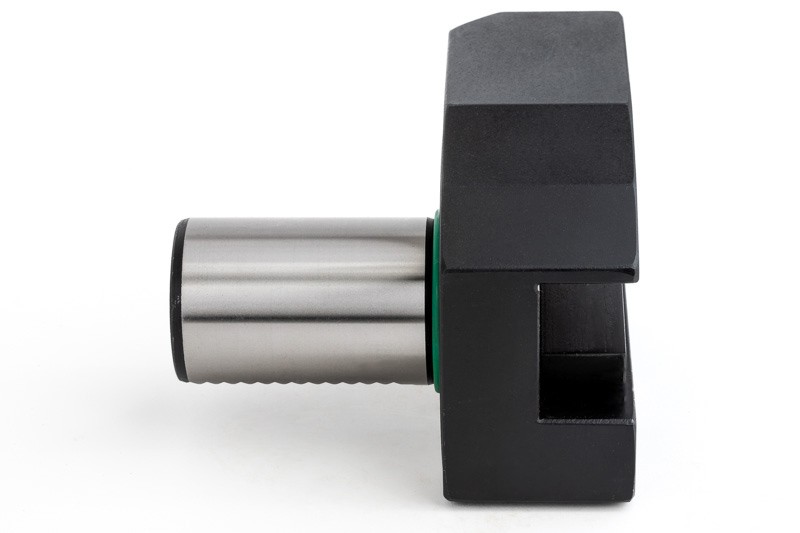

VDI40, 25mm Square Shank External (OD) Extended Static Turning Holder
Part #: 04-1002
VDI40MOD-25-LONG
Price: 335.95 ( / unit)
Price: 7248.95 ( / unit)
Price: 2157.95 ( / unit)
Price: 289.95 ( / unit)
Price: 1304.95 ( / unit)
Price: 3044.95 ( / unit)
151.97
5074.97
1510.97
202.97
913.97
2131.97
This VDI40 \ DIN 69880 external (OD) extended static turning holder securely clamps 25mm square shank tools for use in Haas machines equipped with 12-station VDI40, 12-station VB10 hybrid (BOT10/VDI40), 12-station VB20/30 hybrid (BOT20/VDI40), 12-station VB40 hybrid (BOT40/VDI40), or 24-station VB24 (VB3024) hybrid (BOT24/VDI40) turrets.
Machine Models ST-25, ST-10LY, ST-20, DS-30SSY, ST-10Y, ST-45, ST-28L, ST-10L, ST-20SSY, ST-30SSY, ST-10, ST-40L, ST-15, ST-35, ST-30, ST-28, ST-30L, ST-30SS, ST-20SS, ST-15L, ST-15LY, ST-35Y, ST-30Y, ST-45L, ST-40, ST-25Y, DS-30SS, ST-15Y, ST-35L, ST-20L, ST-20Y
Turret Style VDI, VB Hybrid
Turret Stations 12-Station, 24-Station
Main Spindle Turret VB20/30, VB24 (VB3024), VB10, VB40, VDI40
Toolholder Series VDI40
Holder Type External Turning

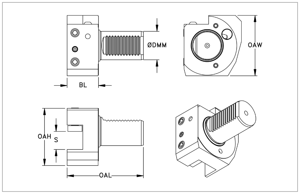

[S] Tool Shank Size 25.0 mm
[ØDMM] Shank Diameter 40.0 mm
[BL] Body Length 44.0 mm
[OAL] Overall Length 107.0 mm
[OAW] Overall Width 118.0 mm
[OAH] Overall Height 80.5 mm
Weight 7.0 lbs \ 3.2 kg
Country of Origin USA
