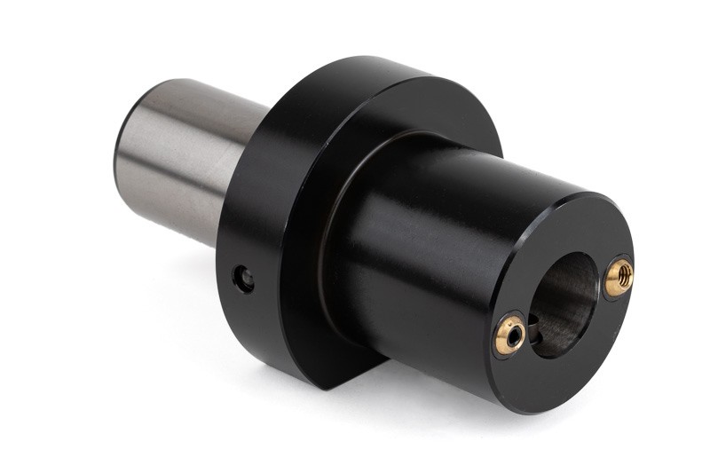

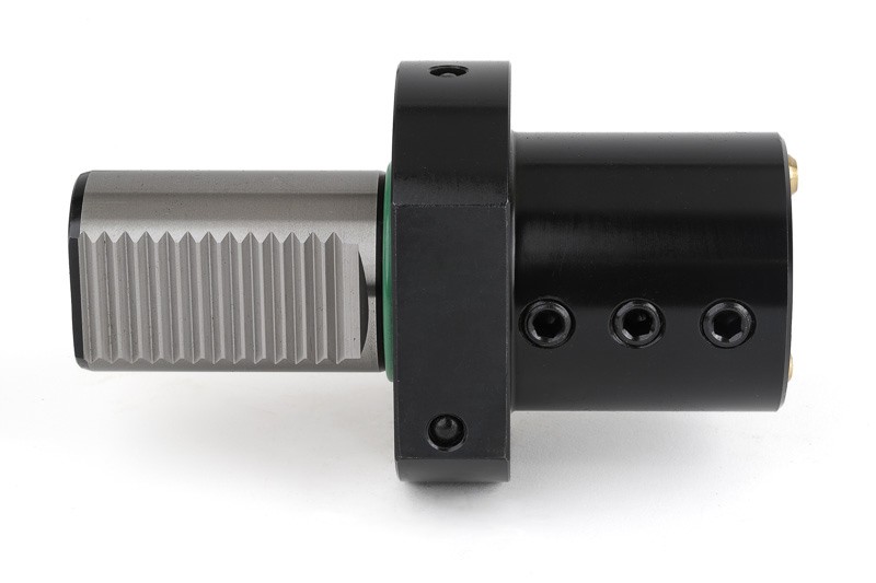

VDI40, 1" Ø Internal (ID) Static Turning Holder
Part #: 04-1003
VDI40ID-1
Price: 262.95 ( / unit)
118.97
This VDI40 \ DIN 69880 internal (ID) static turning holder securely clamps 1.0 in \ 1" round shank tools for use in Haas machines equipped with 12-station VDI40, 12-station VB10 hybrid (BOT10/VDI40), 12-station VB20/30 hybrid (BOT20/VDI40), 12-station VB40 hybrid (BOT40/VDI40), or 24-station VB24 (VB3024) hybrid (BOT24/VDI40) turrets.
Machine Models ST-15L, ST-10L, ST-30SSY, ST-40, ST-20SS, ST-15, DS-30SSY, DS-30SS, ST-45, ST-20Y, ST-20SSY, ST-10, ST-30L, ST-30SS, ST-28, ST-10LY, ST-45L, ST-20, ST-35L, ST-20L, ST-35, ST-35Y, ST-25, ST-10Y, ST-30, ST-28L, ST-40L, ST-25Y, ST-15LY, ST-30Y, ST-15Y
Turret Style VDI, VB Hybrid
Turret Stations 12-Station, 24-Station
Main Spindle Turret VB20/30, VB10, VDI40, VB24 (VB3024), VB40
Toolholder Series VDI40
Holder Type Internal Turning

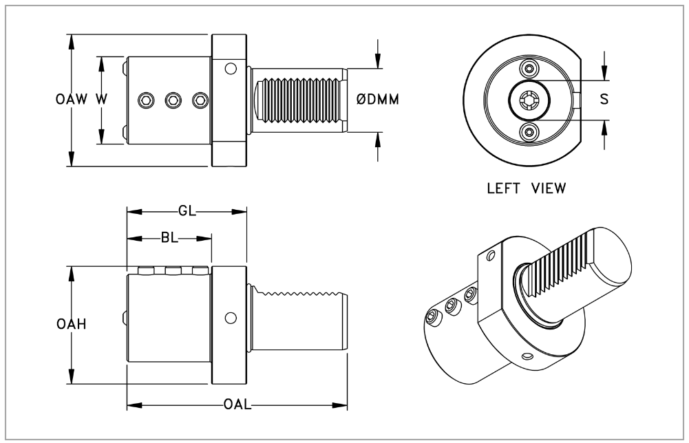

[S] Tool Shank Size 1.0 in \ 1"
[ØDMM] Shank Diameter 1.575 in
[BL] Body Length 2.087 in
[GL] Gage Length 2.953 in
[W] Width 2.165 in
[OAL] Overall Length 5.433 in
[OAW] Overall Width 3.268 in
[OAH] Overall Height 2.913 in
Weight 7.0 lbs \ 3.2 kg
Country of Origin USA
