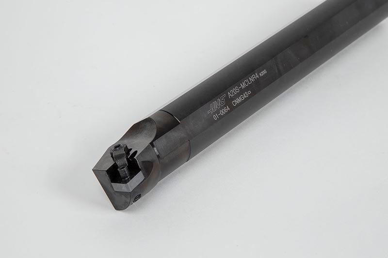

A20S-MCLNR4, 1-1/4" Ø Steel Shank Internal (ID) Boring Bar, Right-Hand, Multi-Lock, Through-Tool Coolant
Part #: 01-0064
A20S-MCLNR4
Price: 162.95 ( / unit)
105.97
Technical Documents
Type of Bar A - Steel Bar + Coolant
Clamping Type M - Multi-Lock
Tool Orientation Internal
Hand of Tool Right

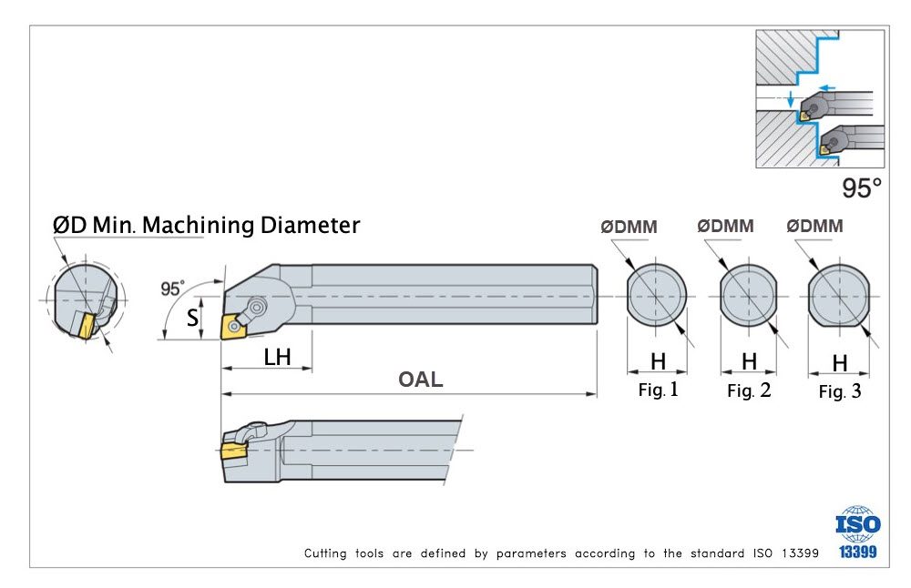

Insert Size CNㅁㅁ43ㅁ / CNㅁㅁ1204ㅁㅁ
[ØD] Min. Machining Diameter 1.705 in
[ØDMM] Shank Diameter 1.25 in
[LH] Head Length 1.969 in
[OAL] Overall Length 10.0 in
[H] Shank Height  1.171 in
[S] Center to Insert Dimension 0.765 in
[°] Lead Angle 95 Degree
Figure 3

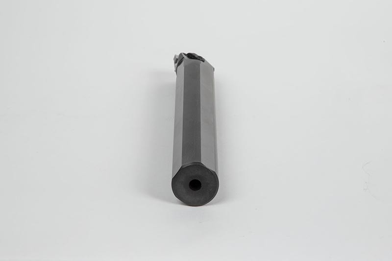

Through Tool Coolant Yes
Weight 3.1 lbs \ 1.4 kg
