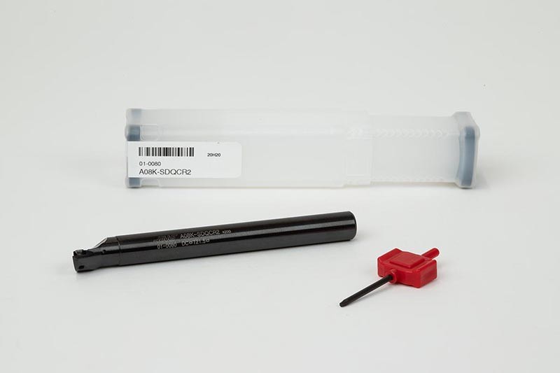

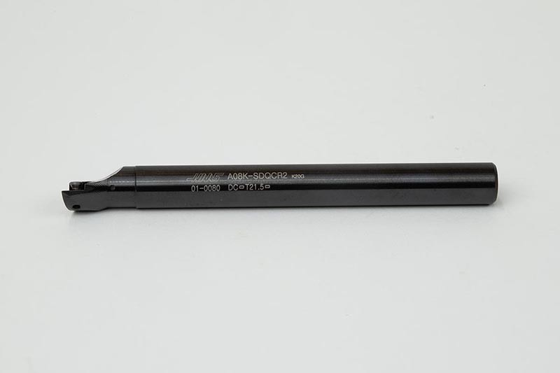

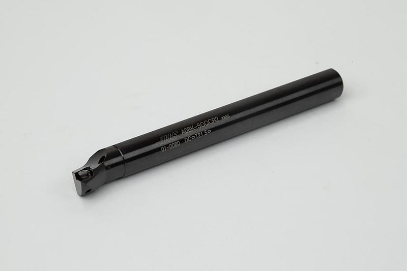

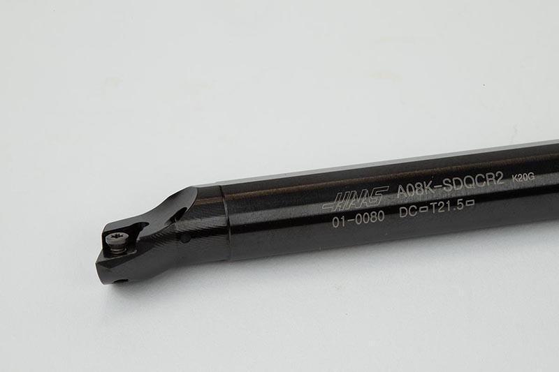

A08K-SDQCR2, 1/2" Ø Steel Shank Internal (ID) Boring Bar, Right-Hand, Screw-Lock, Through-Tool Coolant
Part #: 01-0080
A08K-SDQCR2
Price: 78.95 ( / unit)
47.97
Technical Documents

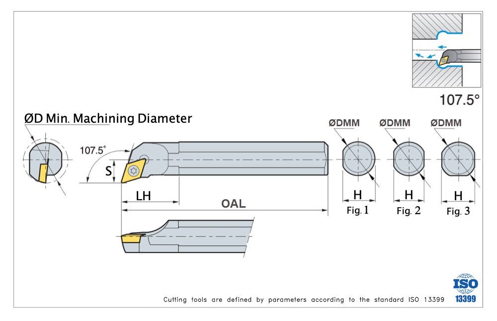

Type of Bar A - Steel Bar + Coolant
Clamping Type S - Screw-On
Tool Orientation Internal
Hand of Tool Right
Insert Style D Style - 55° Rhombic
Insert Size DCㅁㅁ215ㅁ / DCㅁㅁ0702ㅁㅁ
[ØD] Min. Machining Diameter 0.73 in
[ØDMM] Shank Diameter 0.5 in
[LH] Head Length 0.866 in
[OAL] Overall Length 5.0 in
[H] Shank Height  0.48 in
[S] Center to Insert Dimension 0.437 in
[°] Lead Angle 108 Degree
[IC] Inscribed Circle Diameter 0.25 in \ 6.35 mm
[D1] Insert Hole Size 0.11 in \ 2.8 mm
Figure 1
Through Tool Coolant Yes
Weight 0.3 lbs \ 0.1 kg
