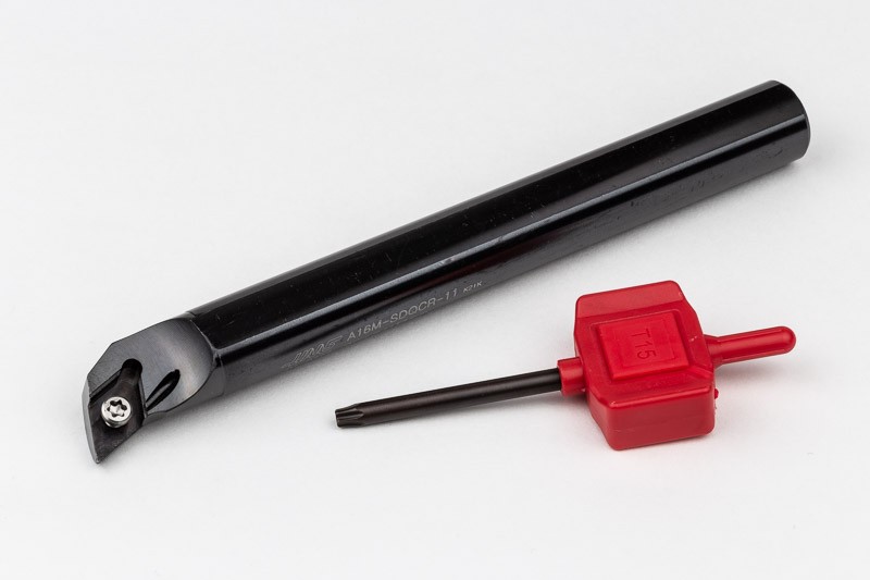

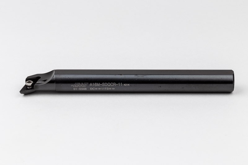

A16M-SDQCR-11, 16mm Ø Steel Shank Internal (ID) Boring Bar, Right-Hand, Screw-Lock, Through-Tool Coolant
Part #: 01-0348
A16M-SDQCR-11
Price: 90.95 ( / unit)
Price: 1648.95 ( / unit)
Price: 490.95 ( / unit)
Price: 65.95 ( / unit)
Price: 296.95 ( / unit)
Price: 692.95 ( / unit)
63.97
1174.97
349.97
46.97
211.97
493.97
Type of Bar A - Steel Bar + Coolant
Clamping Type S - Screw-On
Tool Orientation Internal
Hand of Tool Right
Insert Style D Style - 55° Rhombic
Insert Size DCㅁㅁ325ㅁ / DCㅁㅁ11T3ㅁㅁ
[ØD] Min. Machining Diameter 20.0 mm
[ØDMM] Shank Diameter 16.0 mm
[LH] Head Length 25.0 mm
[OAL] Overall Length 150.0 mm
[H] Shank Height  15.0 mm
[S] Center to Insert Dimension 25.0 mm
[°] Lead Angle 108 Degree
[D1] Insert Hole Size 0.173 in \ 4.4 mm
[L10] Cutting Edge Length 0.458 in \ 11.63 mm
Figure 1
Through Tool Coolant Yes
Weight 0.5 lbs \ 0.2 kg
