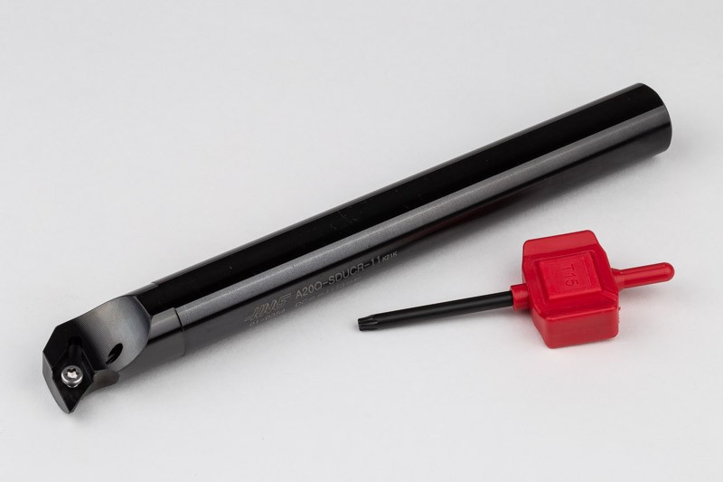

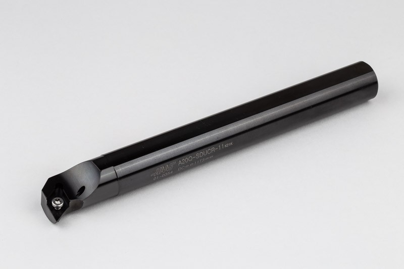

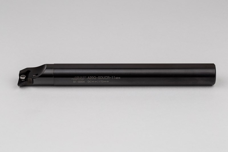

A20Q-SDUCR-11, 20mm Ø Steel Shank Internal (ID) Boring Bar, Right-Hand, Screw-Lock, Through-Tool Coolant
Part #: 01-0354
A20Q-SDUCR-11
Price: $110.95 ( / unit)
Price: 1998.95 ( / unit)
Price: 594.95 ( / unit)
Price: 79.95 ( / unit)
Price: 359.95 ( / unit)
Price: 839.95 ( / unit)
$77.97
1399.97
416.97
55.97
251.97
587.97
Type of Bar A - Steel Bar + Coolant
Clamping Type S - Screw-On
Tool Orientation Internal
Hand of Tool Right
Insert Style D Style - 55° Rhombic
Insert Size DCㅁㅁ325ㅁ / DCㅁㅁ11T3ㅁㅁ
[ØD] Min. Machining Diameter 25.0 mm
[ØDMM] Shank Diameter 20.0 mm
[LH] Head Length 32.0 mm
[OAL] Overall Length 180.0 mm
[H] Shank Height  19.0 mm
[S] Center to Insert Dimension 13.0 mm
[°] Lead Angle 93 Degree
[D1] Insert Hole Size 0.173 in \ 4.4 mm
[L10] Cutting Edge Length 0.458 in \ 11.63 mm
Figure 1
Through Tool Coolant Yes
Weight 0.9 lbs \ 0.4 kg
