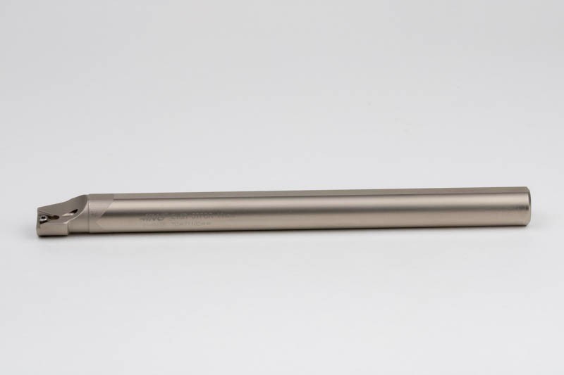

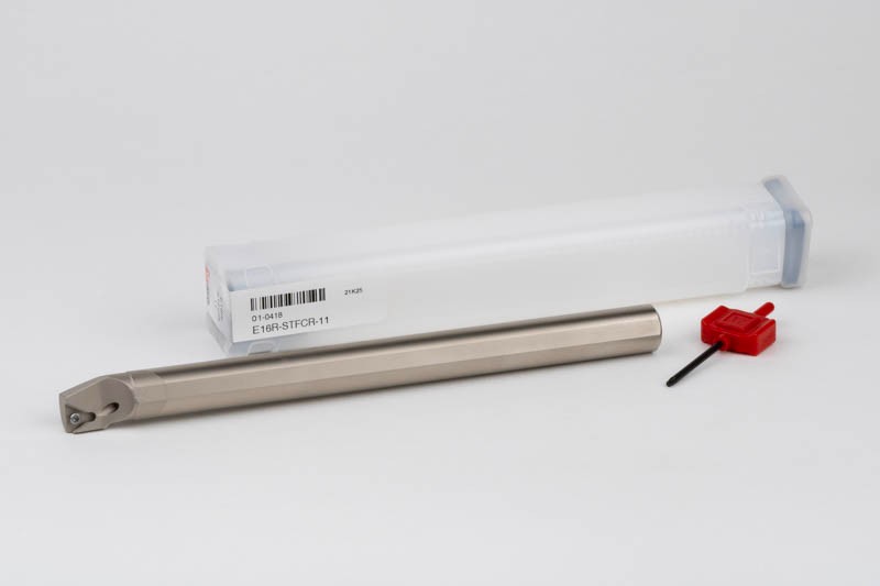

E16R-STFCR-11, 16mm Ø Carbide Shank Internal (ID) Boring Bar, Right-Hand, Screw-Lock, Through-Tool Coolant
Part #: 01-0418
E16R-STFCR-11
Price: 330.95 ( / unit)
Price: 4523.95 ( / unit)
Price: 1346.95 ( / unit)
Price: 180.95 ( / unit)
Price: 814.95 ( / unit)
Price: 1899.95 ( / unit)
297.97
3849.97
1145.97
153.97
692.97
1616.97
Technical Documents
  • Technical Information
Type of Bar E - Carbide Shank + Coolant
Clamping Type S - Screw-On
Tool Orientation Internal
Hand of Tool Right
Insert Style T Style - Triangle
Insert Size TCㅁㅁ215ㅁ / TCㅁㅁ1102ㅁㅁ
[ØD] Min. Machining Diameter 20.0 mm
[ØDMM] Shank Diameter 16.0 mm
[OAL] Overall Length 200.0 mm
[H] Shank Height  15.0 mm
[S] Center to Insert Dimension 11.0 mm
[°] Lead Angle 91 Degree
[IC] Inscribed Circle Diameter 0.25 in \ 6.35 mm
[D1] Insert Hole Size 0.11 in \ 2.8 mm
[L10] Cutting Edge Length 0.433 in \ 11.0 mm
Figure 2
Through Tool Coolant Yes
Weight 1.2 lbs \ 0.5 kg
