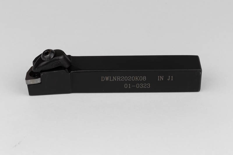

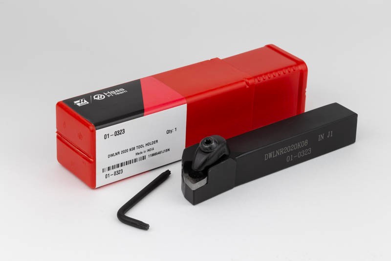

DWLNR2020-K08, 20mm Square Steel Shank External (OD) Turning Tool, Right-Hand, Double Clamp-Lock
Part #: 01-0323
DWLNR 2020 K08
Price: 88.95 ( / unit)
Price: 1498.95 ( / unit)
Price: 446.95 ( / unit)
Price: 59.95 ( / unit)
Price: 269.95 ( / unit)
Price: 629.95 ( / unit)
57.97
1049.97
312.97
41.97
188.97
440.97
Clamping Type D - Double-Clamp
Insert Style W Style - Trigon
Tool Orientation External
Hand of Tool Right
[LH] Head Length 33.0 mm
[OAL] Overall Length 125.0 mm
[H1] Cutting Height 20.0 mm
[H] Shank Height 20.0 mm
[B] Shank Width 20.0 mm
[f] Dimension 25.0 mm
[°] Lead Angle 95 Degree
[L10] Cutting Edge Length 0.342 in \ 8.69 mm
Machine Side Adapter Type Square Shank
Through Tool Coolant No
Weight 0.8 lbs \ 0.4 kg
Country of Origin India
