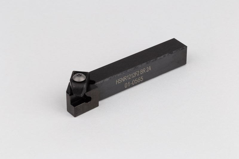

  • Technical Details
Clamping Type HN - Haas Notch
Tool Orientation External
Hand of Tool Right
Insert Style Profiling, Grooving, Threading
Insert Size 2
Hand of Insert Right
[LH] Head Length 19.0 mm
[OAL] Overall Length 80.0 mm
[H] Shank Height 12.0 mm
[B] Shank Width 12.0 mm
[f] Dimension 16.0 mm
[T-MAX] Maximum Depth 3.51 mm
Through Tool Coolant No
Weight 0.4 lbs \ 0.2 kg
Country of Origin India
