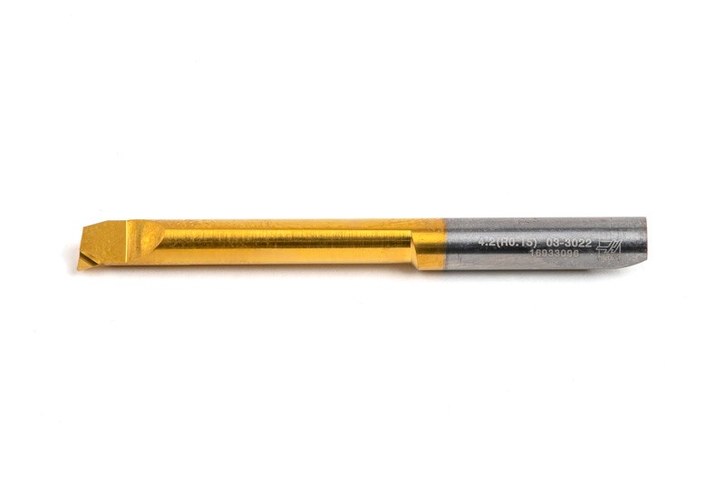

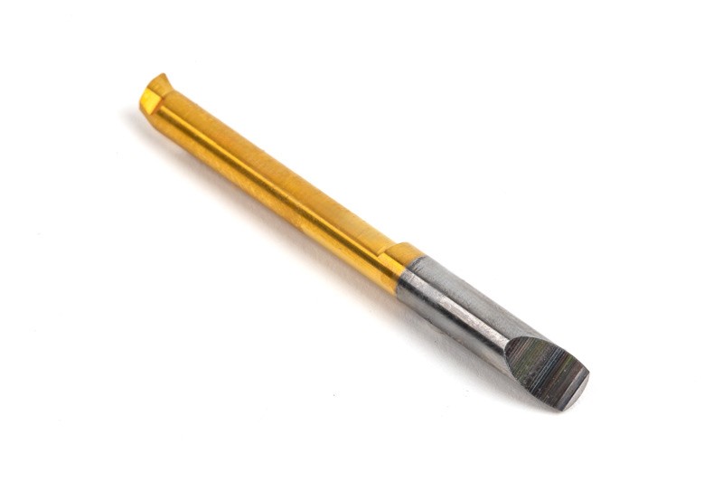

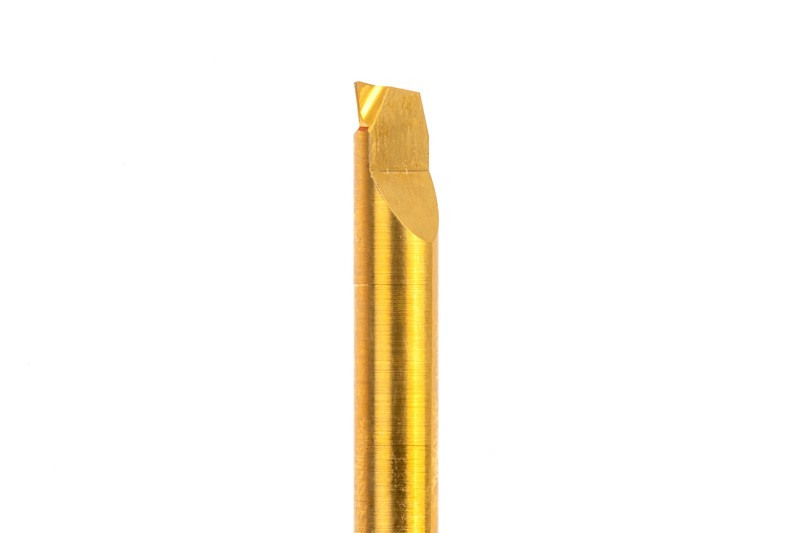

HMB-4, 4mm Ø Carbide Internal (ID) Micro Boring/Profiling Tool, 4.2mm Min. Dia. x 25mm Head Length, Right-Hand
Part #: 03-3022
MICRO TURN, HMB-4R4.2-25-15 TIN
Price: $26.95 ( / unit)
Price: 548.95 ( / unit)
Price: 163.95 ( / unit)
Price: 21.95 ( / unit)
Price: 98.95 ( / unit)
Price: 230.95 ( / unit)
399.97
118.97
15.97
71.97
167.97
$25.60 (Save 5%)
ISO MATERIAL CHART
Type Tool
Toolpath Type ID Turn
Tool Orientation Internal
Hand of Tool Right
Insert Style HMB - Boring/Profiling
Secondary Workpiece Material M - Stainless Steel, S - High Temp Alloys
Material Carbide
Coating TiN
Connection Size 4
[ØD] Min. Machining Diameter 0.165 in \ 4.2 mm
[ØDMM] Shank Diameter 0.157 in \ 4.0 mm
[LH] Head Length 0.984 in \ 25.0 mm
[OAL] Overall Length 1.693 in \ 43.0 mm
[OHX] Maximum Overhang 1.1 in \ 28.0 mm
[RE] Corner Radius 0.006 in \ 0.15 mm
[T-MAX] Maximum Depth 0.012 in \ 0.3 mm
[S] Center to Insert Dimension 0.077 in \ 1.95 mm
