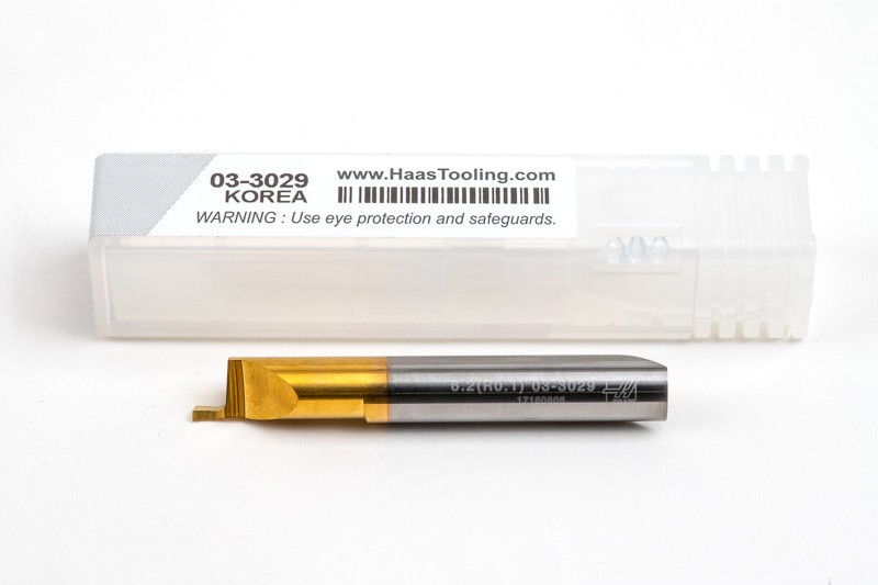

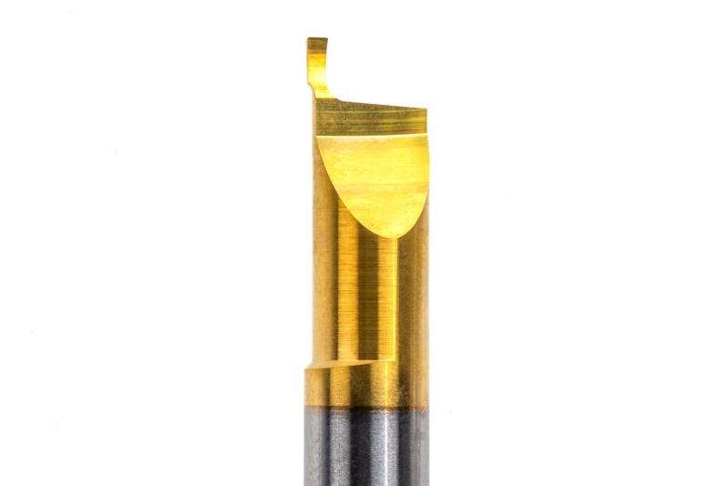

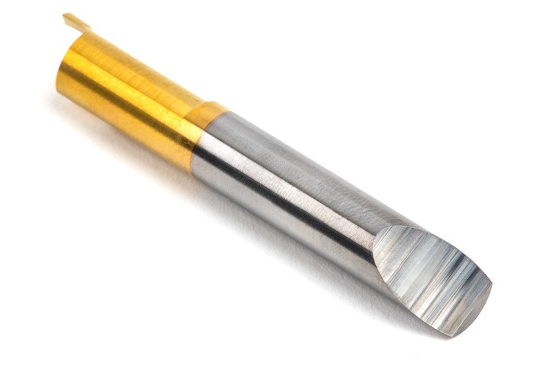

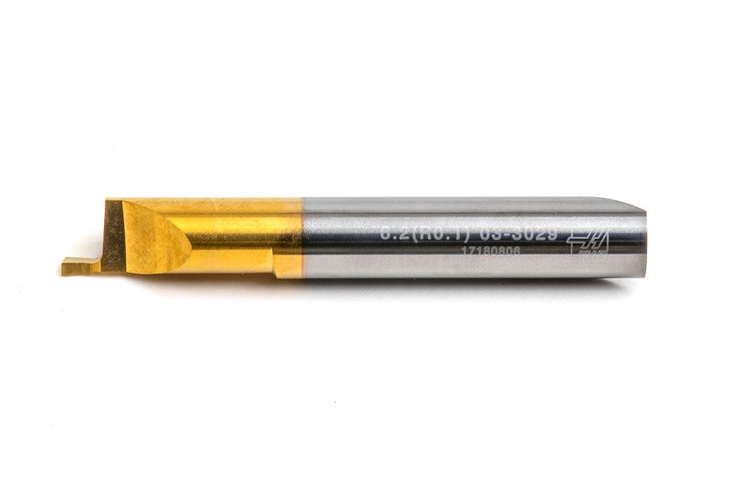

HMFGI-6, 6mm Ø Carbide Internal (ID) Micro Face Grooving Tool, 1mm Cut Width, Right-Hand
Part #: 03-3029
MICRO TURN, HMFGI-6R6.2-15-10-20 TIN
Price: 34.95 ( / unit)
Price: 748.95 ( / unit)
Price: 222.95 ( / unit)
Price: 29.95 ( / unit)
Price: 134.95 ( / unit)
Price: 314.95 ( / unit)
29.97
524.97
156.97
20.97
94.97
220.97
ISO MATERIAL CHART
Type Tool
Toolpath Type Face Groove
Tool Orientation Internal
Hand of Tool Right
Insert Style HMFGI - Face Grooving Internal
Secondary Workpiece Material M - Stainless Steel, S - High Temp Alloys
Material Carbide
Coating TiN
Connection Size 6
[ØD] Min. Machining Diameter 0.244 in \ 6.2 mm
[ØDMM] Shank Diameter 0.236 in \ 6.0 mm
[LH] Head Length 0.591 in \ 15.0 mm
[OAL] Overall Length 1.693 in \ 43.0 mm
[OHX] Maximum Overhang 0.81 in \ 20.5 mm
[CW] Cutting Width 0.039 in \ 1.0 mm
[RE] Corner Radius 0.004 in \ 0.1 mm
[T-MAX] Maximum Depth 0.079 in \ 2.0 mm
[S] Center to Insert Dimension 0.116 in \ 2.95 mm
