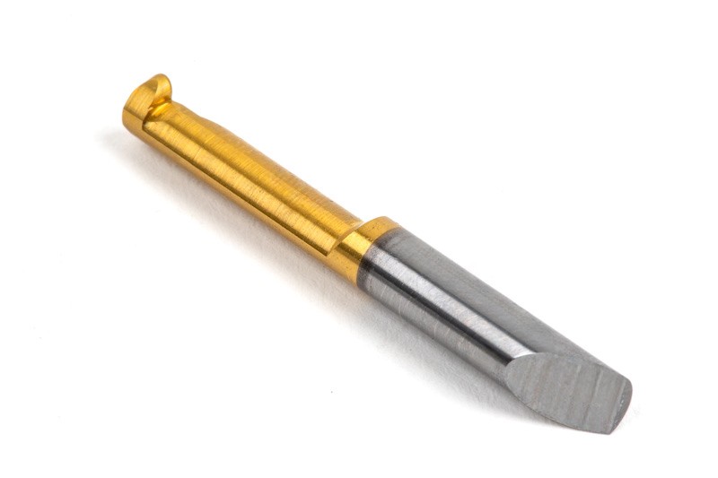

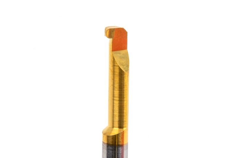

HMRG-4, 4mm Ø Carbide Internal (ID) Micro Radius Grooving Tool, 1.5mm Cut Width, Right-Hand
Part #: 03-3033
MICRO TURN, HMRG-4R4.2-15-15-08 TIN
Price: 23.95 ( / unit)
Price: 498.95 ( / unit)
Price: 148.95 ( / unit)
Price: 19.95 ( / unit)
Price: 89.95 ( / unit)
Price: 209.95 ( / unit)
14.97
349.97
103.97
13.97
62.97
146.97
ISO MATERIAL CHART
Type Tool
Toolpath Type ID Groove
Tool Orientation Internal
Hand of Tool Right
Insert Style HMRG - Radius Grooving
Secondary Workpiece Material S - High Temp Alloys, M - Stainless Steel
Material Carbide
Coating TiN
Connection Size 4
[ØD] Min. Machining Diameter 0.165 in \ 4.2 mm
[ØDMM] Shank Diameter 0.157 in \ 4.0 mm
[LH] Head Length 0.591 in \ 15.0 mm
[OAL] Overall Length 1.299 in \ 33.0 mm
[OHX] Maximum Overhang 0.71 in \ 18.0 mm
[CW] Cutting Width 0.059 in \ 1.5 mm
[RE] Corner Radius 0.03 in \ 0.75 mm
[T-MAX] Maximum Depth 0.031 in \ 0.8 mm
[S] Center to Insert Dimension 0.077 in \ 1.95 mm
