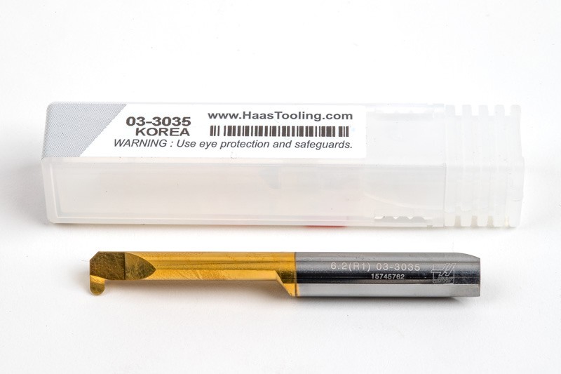

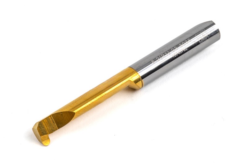

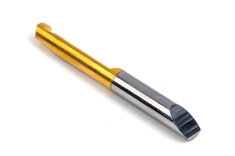

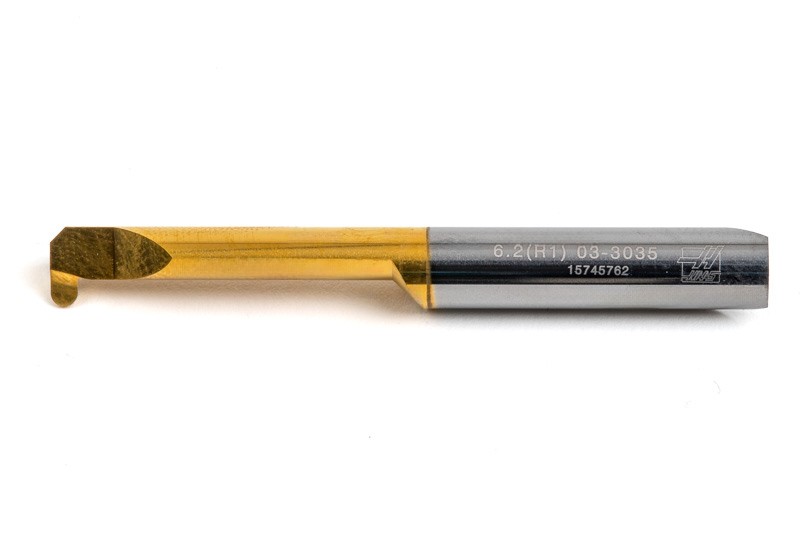

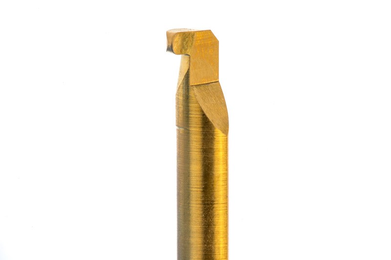

HMRG-6, 6mm Ø Carbide Internal (ID) Micro Radius Grooving Tool, 2mm Cut Width, Right-Hand
Part #: 03-3035
MICRO TURN, HMRG-6R6.2-25-20-18 TIN
Customer Rating:
Price: $33.95 ( / unit)
Price: 723.95 ( / unit)
Price: 215.95 ( / unit)
Price: 28.95 ( / unit)
Price: 130.95 ( / unit)
Price: 303.95 ( / unit)
$20.97
524.97
156.97
20.97
94.97
220.97
$19.92 (Save 5%)
ISO MATERIAL CHART
Type Tool
Toolpath Type ID Groove
Tool Orientation Internal
Hand of Tool Right
Insert Style HMRG - Radius Grooving
Secondary Workpiece Material S - High Temp Alloys, M - Stainless Steel
Material Carbide
Coating TiN
Connection Size 6
[ØD] Min. Machining Diameter 0.244 in \ 6.2 mm
[ØDMM] Shank Diameter 0.236 in \ 6.0 mm
[LH] Head Length 0.984 in \ 25.0 mm
[OAL] Overall Length 2.087 in \ 53.0 mm
[OHX] Maximum Overhang 1.2 in \ 30.5 mm
[CW] Cutting Width 0.079 in \ 2.0 mm
[RE] Corner Radius 0.039 in \ 1.0 mm
[T-MAX] Maximum Depth 0.071 in \ 1.8 mm
[S] Center to Insert Dimension 0.116 in \ 2.95 mm
