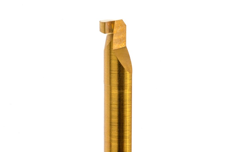

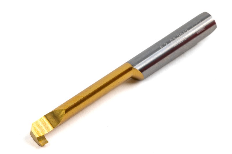

HMG-6, 6mm Ø Carbide Internal (ID) Micro Grooving Tool, 1.98mm Cut Width x 30mm Head Length, Right-Hand
Part #: 03-3043
MICRO TURN, HMG-6R6.2-30-198-18 TIN

ISO MATERIAL CHART
Type Tool
Toolpath Type ID Groove
Tool Orientation Internal
Hand of Tool Right
Insert Style HMG - Grooving
Secondary Workpiece Material M - Stainless Steel, S - High Temp Alloys
Material Carbide
Coating TiN
Connection Size 6
[ØD] Min. Machining Diameter 0.244 in \ 6.2 mm
[ØDMM] Shank Diameter 0.236 in \ 6.0 mm
[LH] Head Length 1.181 in \ 30.0 mm
[OAL] Overall Length 2.283 in \ 58.0 mm
[OHX] Maximum Overhang 1.4 in \ 35.5 mm
[CW] Cutting Width 0.078 in \ 1.98 mm
[T-MAX] Maximum Depth 0.071 in \ 1.8 mm
[S] Center to Insert Dimension 0.116 in \ 2.95 mm
