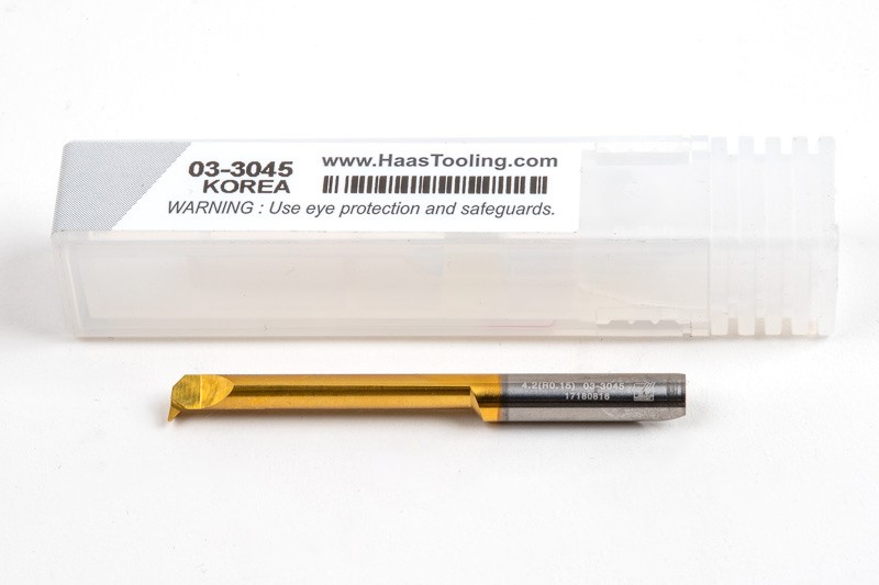

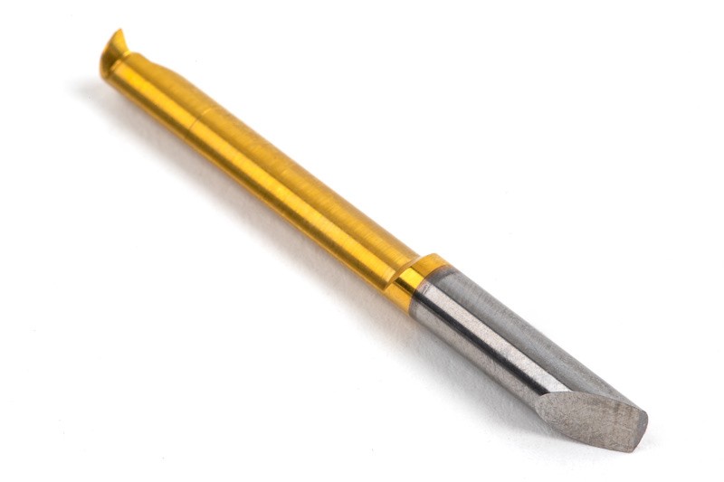

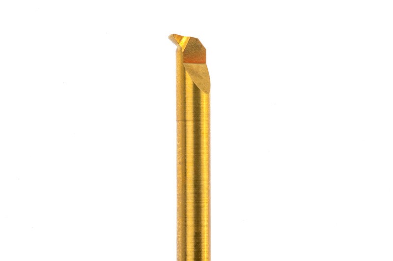

HMPB-4, 4mm Ø Carbide Internal (ID) Micro Profiling Tool, 4.2mm Min. Dia. x 20mm Head Length, Right-Hand
Part #: 03-3045
MICRO TURN, HMPB-4R4.2-20-15 TIN
Price: $23.95 ( / unit)
Price: 498.95 ( / unit)
Price: 148.95 ( / unit)
Price: 19.95 ( / unit)
Price: 89.95 ( / unit)
Price: 209.95 ( / unit)
$14.97
349.97
103.97
13.97
62.97
146.97
$14.22 (Save 5%)
ISO MATERIAL CHART
Type Tool
Toolpath Type ID Turn
Tool Orientation Internal
Hand of Tool Right
Insert Style HMPB - Profiling
Secondary Workpiece Material M - Stainless Steel, S - High Temp Alloys
Material Carbide
Coating TiN
Connection Size 4
[ØD] Min. Machining Diameter 0.165 in \ 4.2 mm
[ØDMM] Shank Diameter 0.157 in \ 4.0 mm
[LH] Head Length 0.787 in \ 20.0 mm
[OAL] Overall Length 1.693 in \ 43.0 mm
[OHX] Maximum Overhang 1.1 in \ 28.0 mm
[RE] Corner Radius 0.006 in \ 0.15 mm
[T-MAX] Maximum Depth 0.012 in \ 0.3 mm
[S] Center to Insert Dimension 0.077 in \ 1.95 mm
